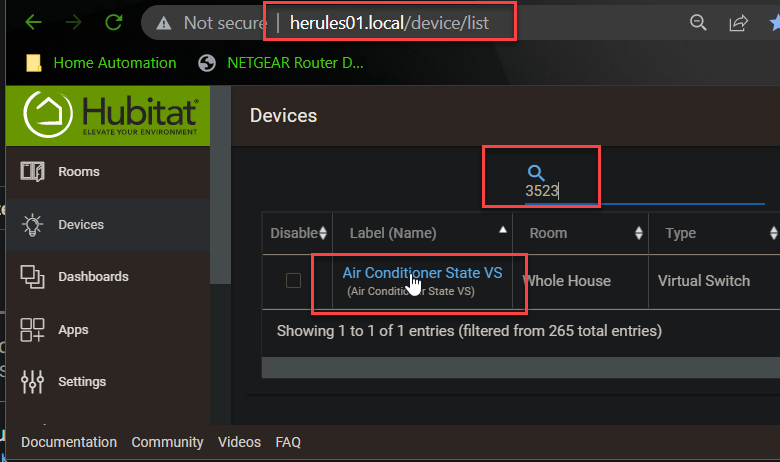

If you know the id, you can also type it in the search field at the top of the device list
