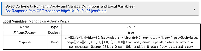

Do this using Rule Machine. With a periodic trigger.
@aaiyar ninjaed me while I was making a sample Rule with the most relevant part...
Not that I'm an expert, but I actually did this.
The string probably has to be converted to a number if you want to do anything with it.
Thanks! I'm getting closer...
Where do I find the "Set Response from GET response"? I'm looking and clicking everywhere ut I can't find this setting :sweat_smile:
You get it if it's a string, vs number, like you have it now.
I'd say, do the string, then convert the string to a number. There's a function for that.

Thank you! Found it after created a string local variable
