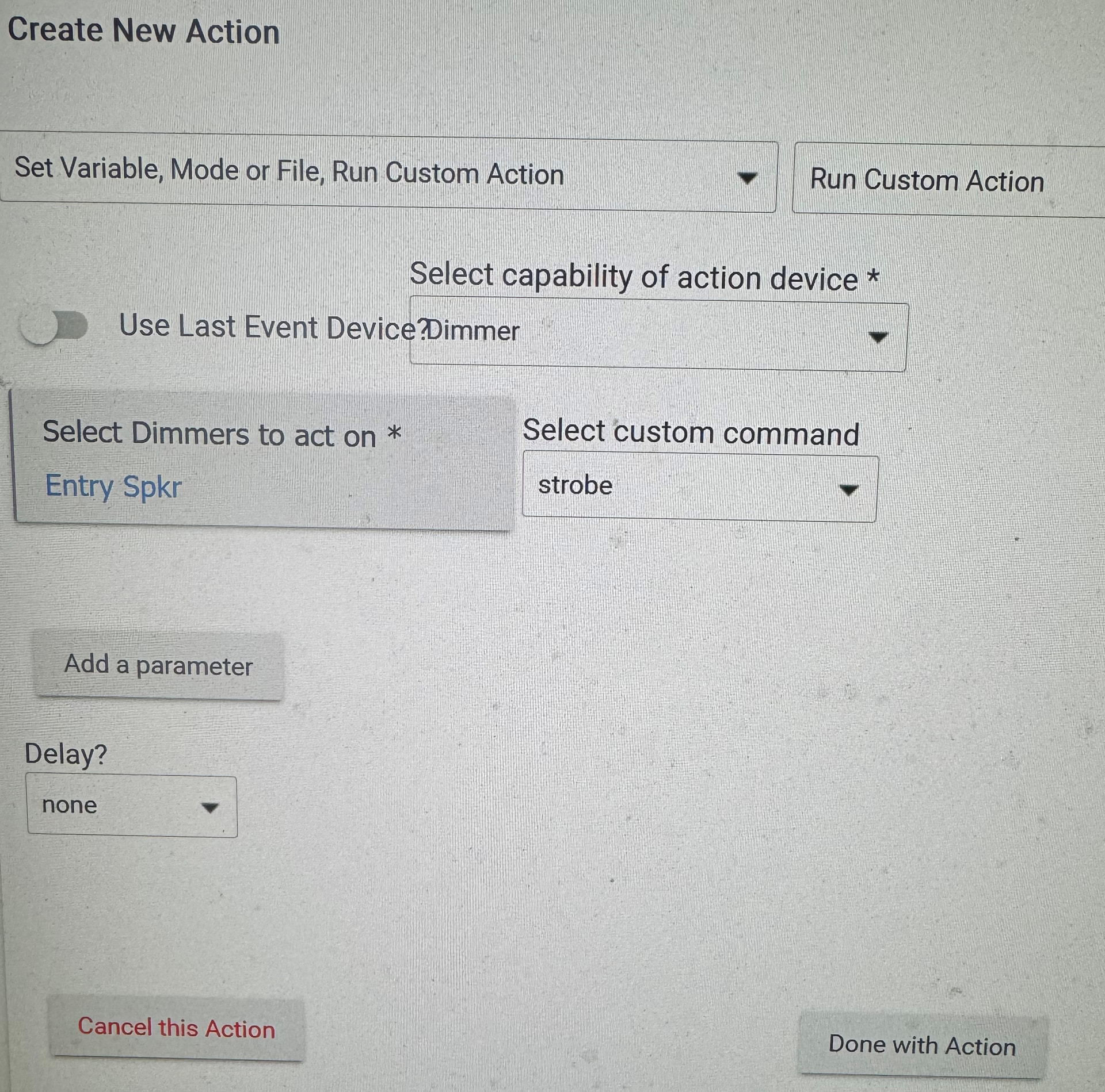

I haven't tested this, but here's where I found it. ("Entry Spkr" is a ZSE50)
Works as @Tom16 described if you treat as Dimmer

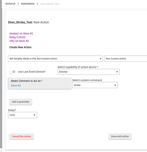

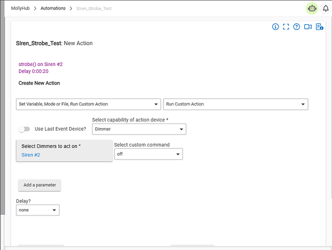

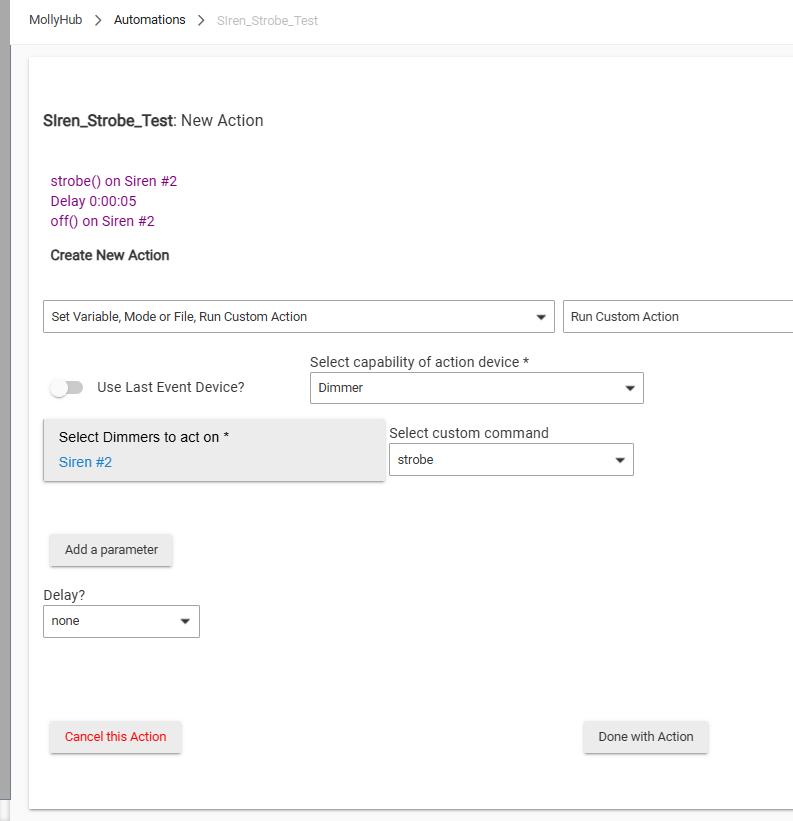

Thank you both. I have it working and am posting the below for others to follow if needed.
  1. My ZSE50 is named "Siren #2"
  2. The ZSE50 strobe capability is "dimmer" not sure why but that's what it is.
RM Code to turn on the strobe light:
RM Code to turn off the strobe light:
