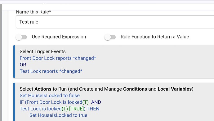

This simple rule would probably do the job.

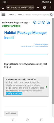

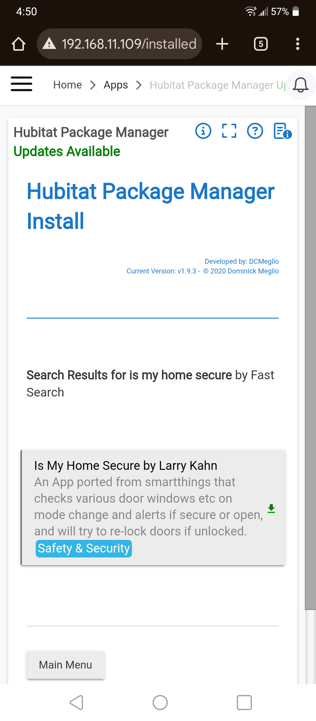

Ummm. I don't believe I asked for a third party messy solution. Rule Manager is the way I work. HPM is not the way I would ever want to go. I want control of any packages I install.
Thanks, tho.

For full transparency here, OP edited the post to add that blurb well after the fact. It wasn't there originally.
Correct. I added it cos I assumed that most people would give solutions - as @user5298 did - which used hubitat-only device drivers, etc.
The reason? I just updated from C7 to C8 pro and NO MATTER DEVICES WORK ... nor do many of my third-party installed device drivers (non-HPM).
I want something that will work update-to-update...and C7 to C8 Pro, etc... I don't think that's too much to assume - when I'm posting in a hubitat "get help" forum.
I don't want things that will give me spousal nightmares if i decide to update my hardware!
So, high-horse and all, but yeah... I go for hubitat-only ... or I won't expect it to work cross-migration. That's not too much to ask.
ps: about an hour after the fact is NOT "well after". I just saw a screenshot of a HPM app - with NO OTHER DETAILS or help!

(nitpick) you can OR multiple devices as part of the same trigger (select "any").
I am not sure what you anticipated might create a loop. Triggers are locks, action sets a variable - no loop possible, unless I'm missing something. Do you plan to operate the locks from within the rule?

Well, that app would have solved your problem, and it was suggested by just about the most helpful person on this forum (and also the app's maintainer). They've even been known to write apps for people just to help them out.
