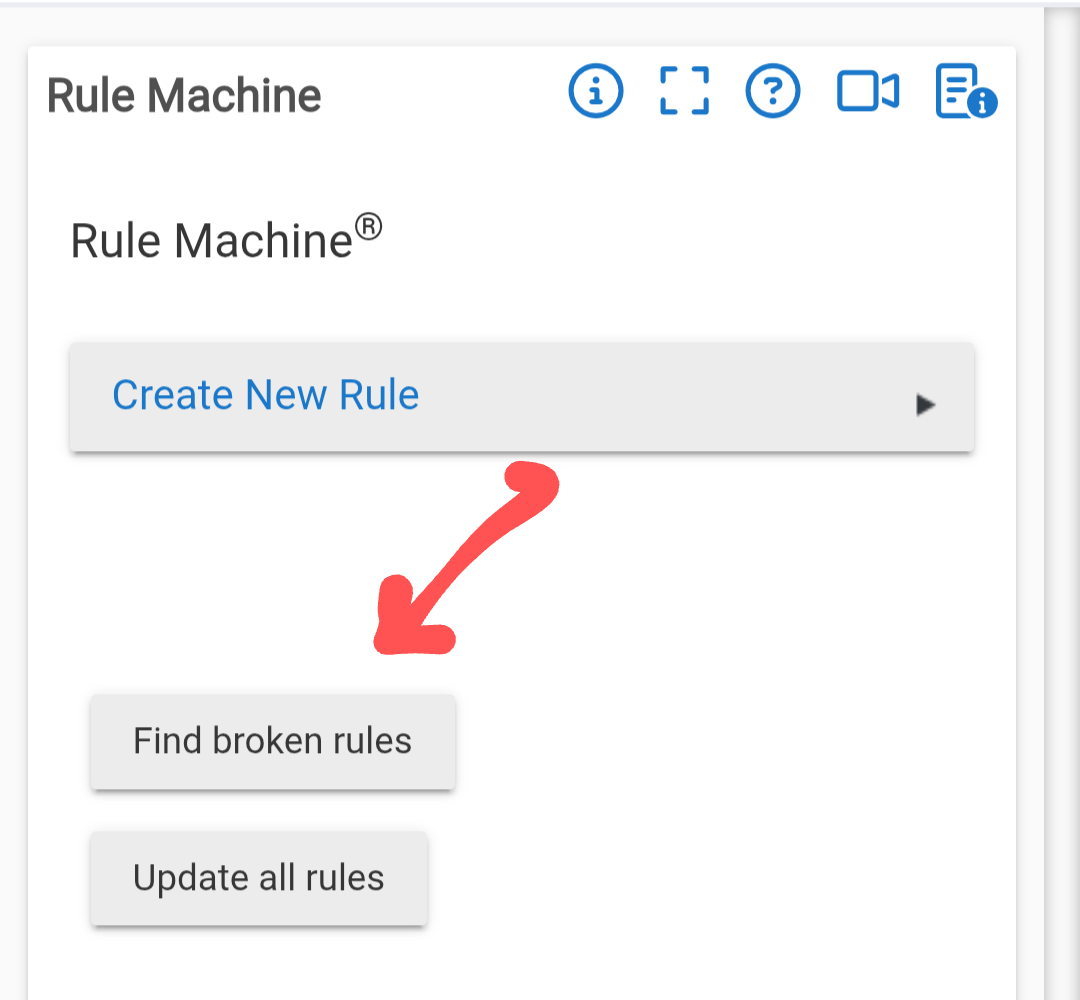

Open Rule Machine to find this button. As for the other apps, AFAIK no such utility, sorry.

Rule Machine can only check for broken rules that were created in rule machine.
It can’t check other apps.

Maybe we should back up a bit: what does a "broken rule" mean to you? In Rule Machine, it is a specific thing that will show up in the UI sometimes when editing actions (usually because you removed a device without heeding the warning to remove it from apps first). Basic Rule doesn't do this, hence the question.
