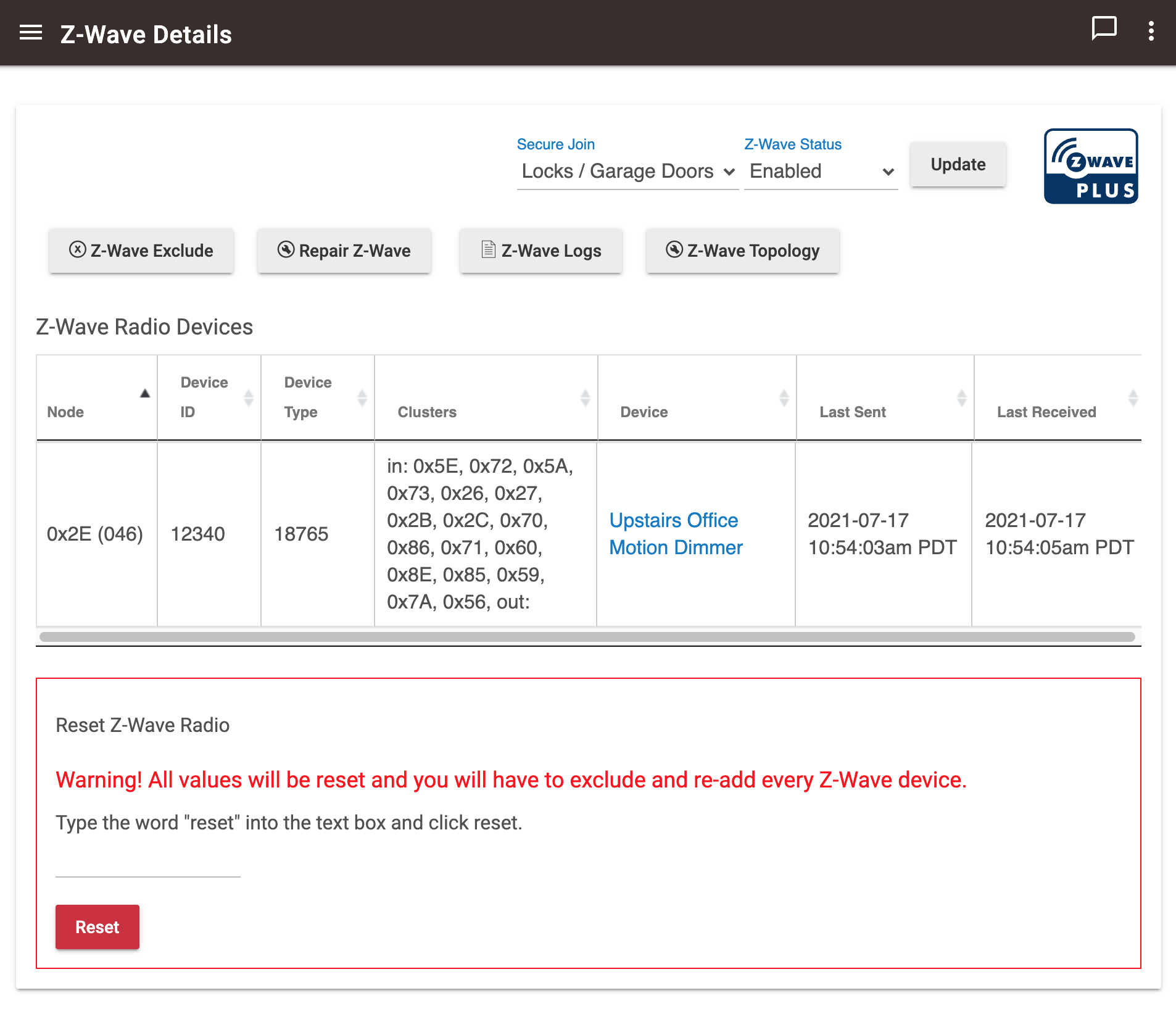

A soft reset shouldn't affect the contents of the Z-Wave radio, but it will erase your "Devices" list (and apps and everything) in Hubitat unless you restore a backup. So, as hinted at above, restoring a backup would be one way to re-associate a Hubitat device with a Z-Wave radio device.
But even without doing that, if you wanted to more or less start over but not have to re-pair Z-Wave devices, you should see all devices the Z-Wave radio knows about in Settings > Z-Wave Details (if not, something went wrong--maybe a full reset or manual reset of this radio?). There, you should have a "Discover" button next to any device Hubitat doesn't know about, and clicking it should create a Hubitat device with the best-match driver, similar to what it would do if you just paired the device.
Hrm, I think something went wrong then. It was a normal soft-reset using version 2.2.8.136 and the devices list was empty immediately after the soft reset.
I tried excluding and re-adding one device to see if that worked, which it did but I think I'm going to have to re-add my 35 z-wave devices now. 35 isn't so bad to re-add.
