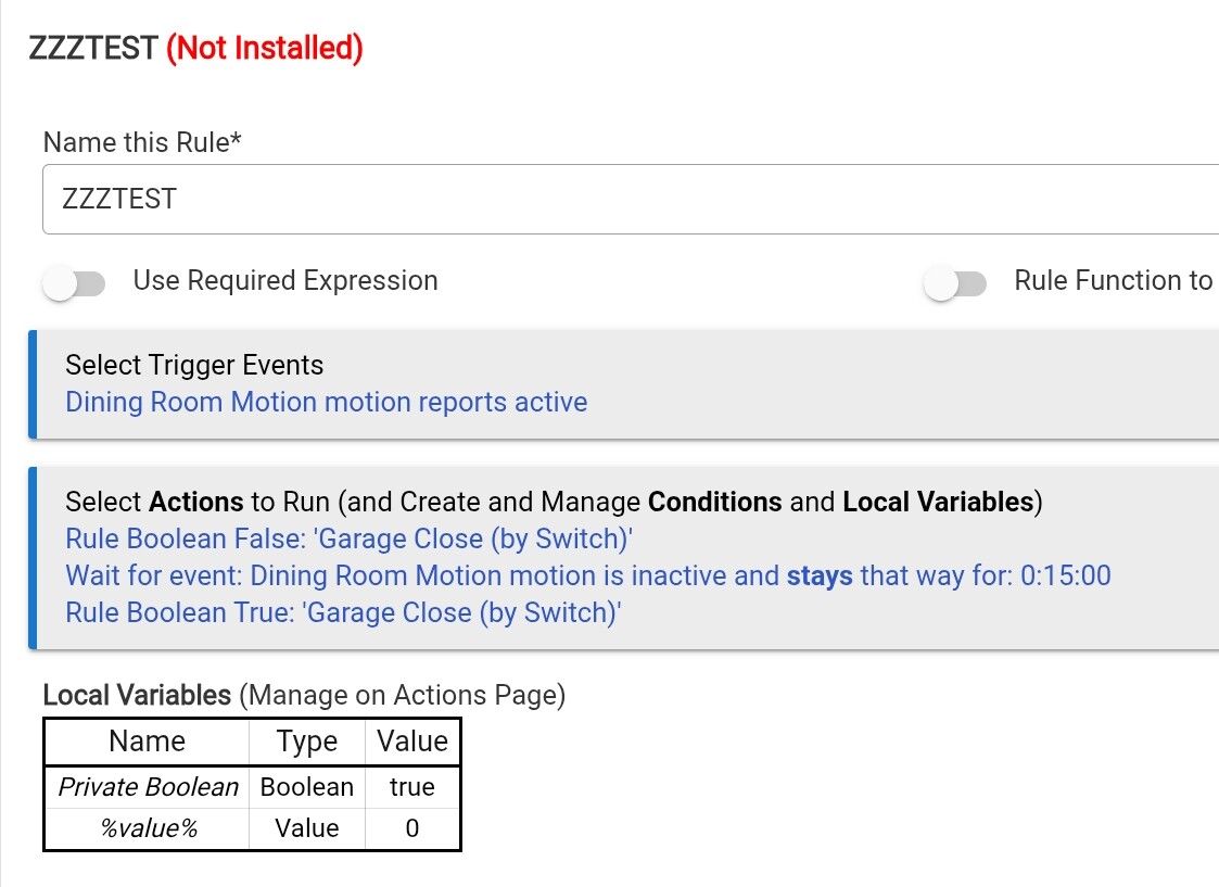

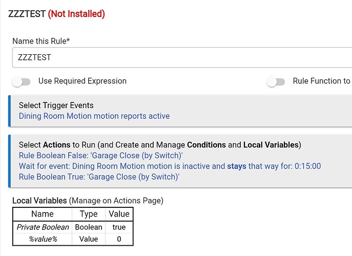

I would probably do this with two rules
Rule 1 -
Trigger - Motion Sensor Active
Actions -
Set Private Boolean False {Your Rule Name} Rule
Wait for Motion sensor Inactive AND STAYS for 15 minutes
Set Private Boolean True {Your Rule Name} Rule

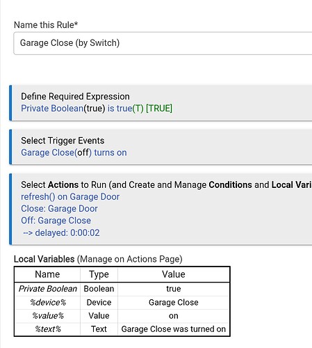

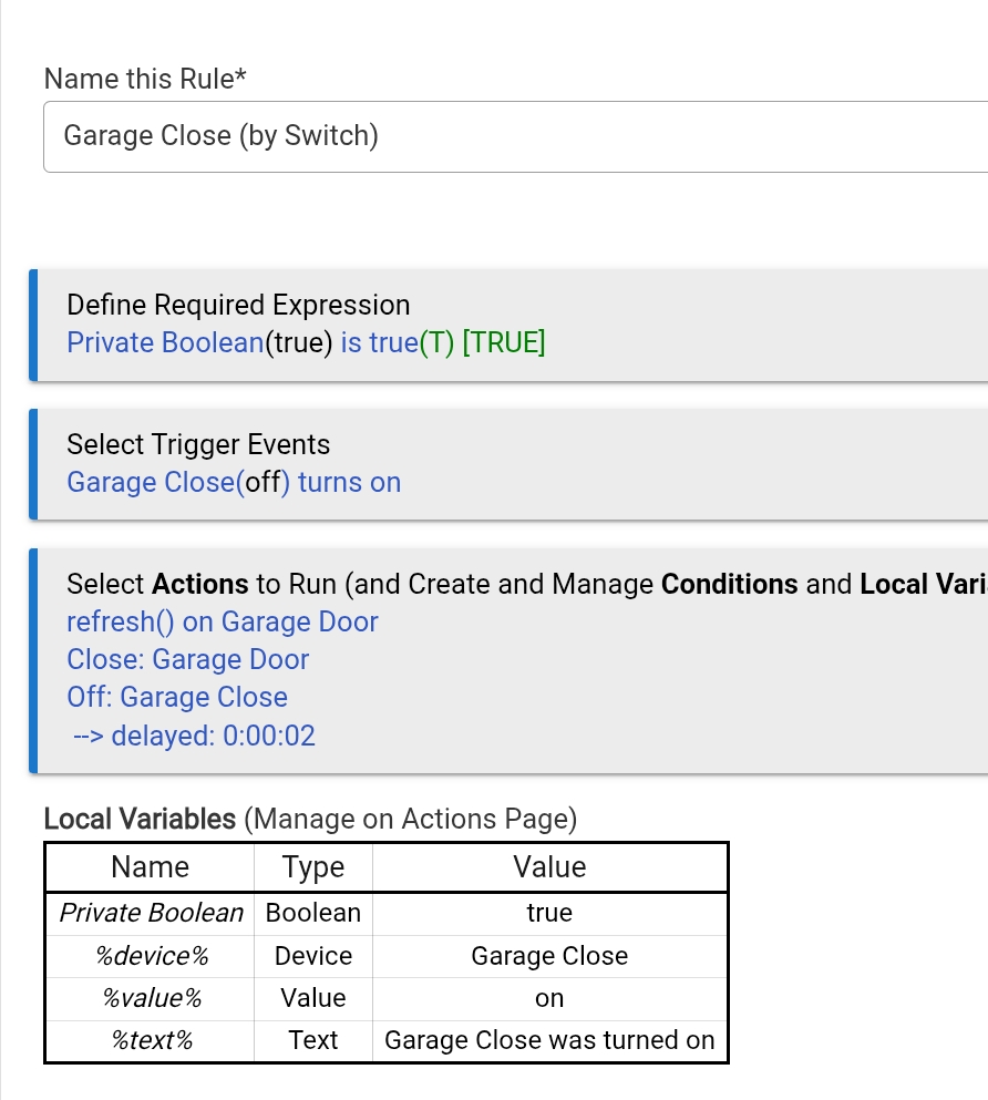

Second Rule (which is the automation for blinds up/down), just add a required expression that Private Boolean is true
Would look like this

My rule doesn't require someone to be in there for 15 minutes. It only requires that they not be active for 15 consecutive minutes if they are initially detected. You could also use a conditional trigger between two times (like the 8-11). I would not use required expression for the first rule, as that could cause an issue if someone is detected at anytime after 10:45 in not resetting the rule.
I didn't know Rule A can control the private boolian (local variable) in Rule B. I thought the local variables were not visible by other rules....super cool
Only that particular local variable. It is a special one, for just this type of use case

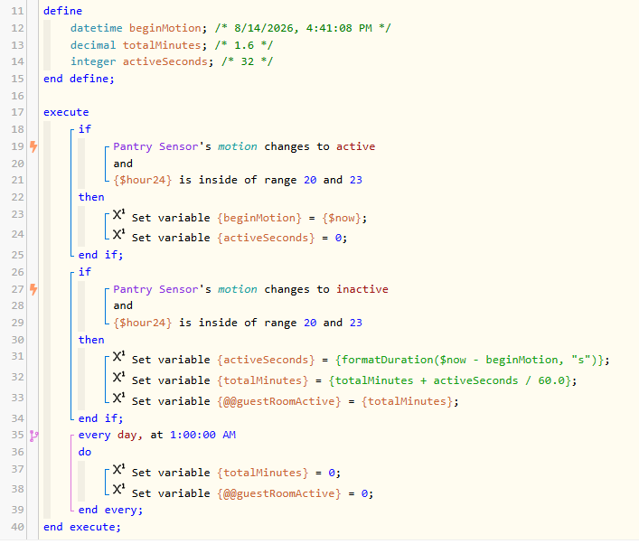

That is how I would do it. If the guest goes in the room 10 times for about a minute, you want to capture that as the room being active for ten minutes.
I'm not an RM guy, but here is a Webcore piston that does that. I tested it and it works great. The sensor I tested with times out in 30 seconds, so I have it track cumulative seconds, and then convert that to minutes to add it to the hub variable.
