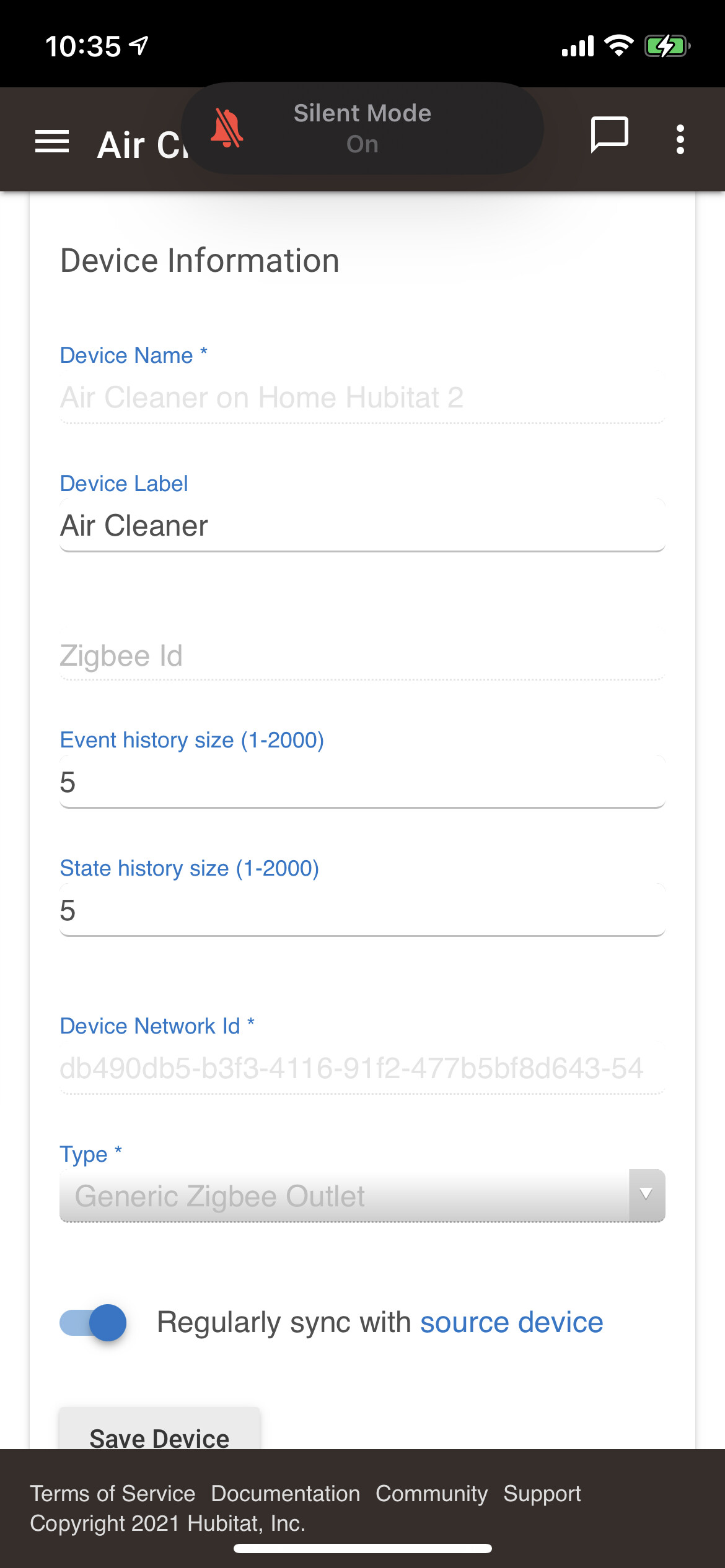

Have you set event and device history lower on devices where you donโ€™t have to have it?
My devices are mostly set to 5&5. The cpu wonโ€™t have to spend as much time freeing up memory if you donโ€™t use as much. I have ES, Alexa, Homebridge, CoCoHue (2Hue hubs), LOMP, and quite a few RM and ML rules and My hubs apps are at 2.2%.

To change the "event history" on all devices at once to 10, you can type this in your web browser's address bar: HubIPaddress/hub/advanced/event/limit/10 Of course you have to replace HubIPaddress with your hubs IP address.
