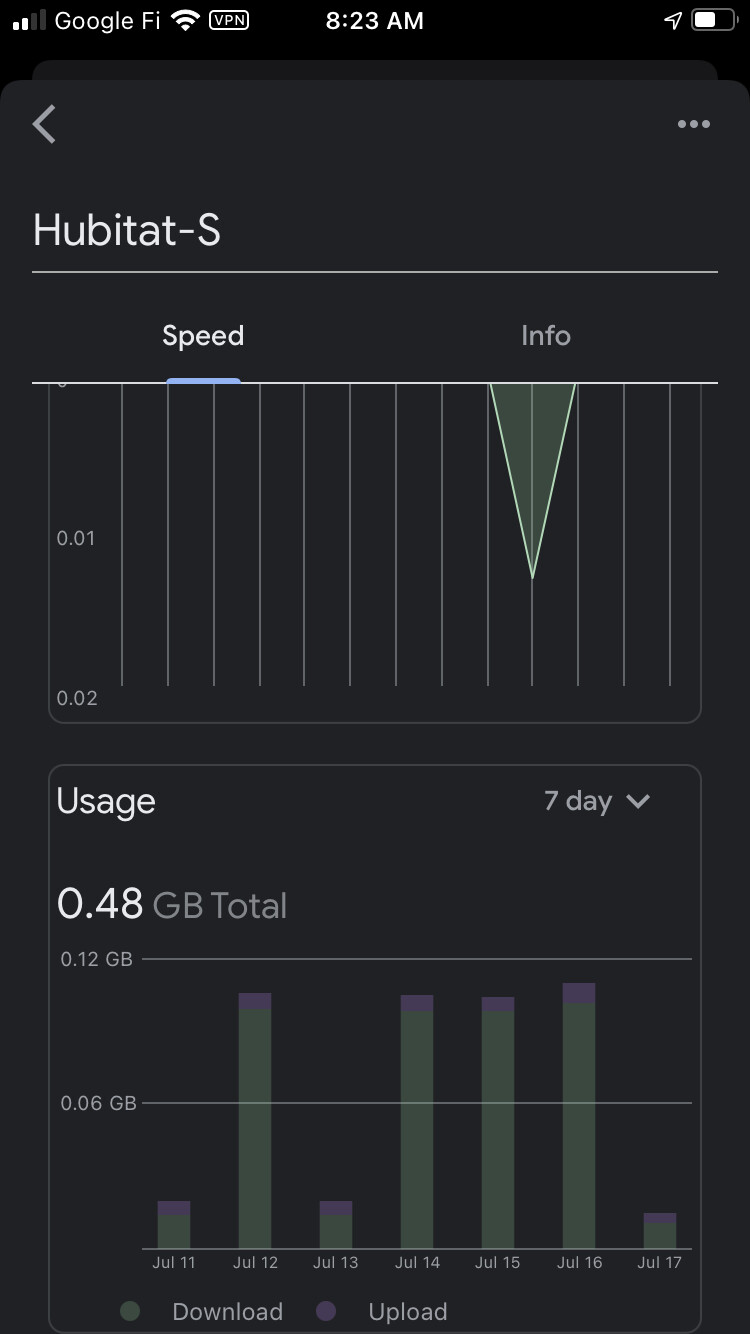

Recently added central management to my home network and was shocked to see this.
The first two are my media servers, the second two are network cameras. I can't imagine what the Hubitat would do with 17 gb of data in less than a week.
My dashboard shows that Hubitat downloaded 15.7 gb of data and uploaded 1.7gb,
Given that HE doesn’t require any connection after registration, I’d have to guess that it is something external driving it. Cloud dashboard would account for some, but shouldn’t anywhere near that.
Are you looking at data passed between the Hubitat and router or between Hubitat to the Internet through the router?

This is all sort of low priority curiosity. I don't have any data caps to worry about and everything seems to be working properly. Just weird data.
