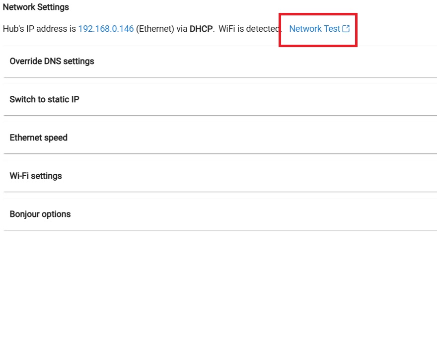

The hub does have a ping utility. In settings โ€”> network setup โ€”> network test menu.

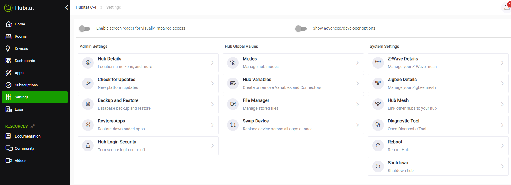

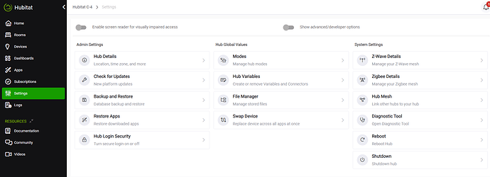

I do not have a Network setup option in the settings screen.
I have vers 2.4.0.146.

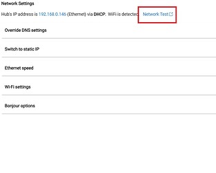

Are you certain? Nothing here? The second screenshot shows where to click to get Ping and other tests.
Yes I'm certain.
Try turning on Advanced/Developer options slider at the top of that page? I don't think that networking is supposed to be hidden by that setting, but maybe it is?
Its a C4 hub, it possibly did not have any network settings available so it is hidden in the UI.
Try going to the url directly. http://HUB.IP/hub/networkTest

http://HUB.IP/hub/networkTestworked, thanks. That's not exactly an obvious thing to do.

Its hidden because you have a C4 which I think has no networks settings available. So the settings page is hidden, which has the link to the network test page within it. Tagging @gopher.ny

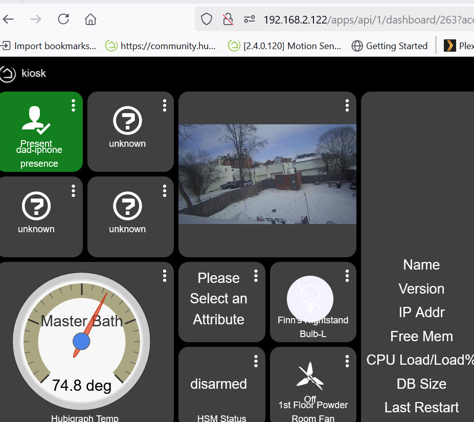

On a whim, I tried the Firefox browser and found the camera pics displayed as they should. I had been using Vivaldi, so I was chasing a browser issue. I then tried the Brave, Opera, and Duckduckgo browsers, all based on Chrome, and none worked. Floorp. which is based on FF, does work. So while now I have to find the common setting in the chrome-based browsers that is preventing the image from displaying, at least I know my VLAN-based network and the camera image-capture strings are working.

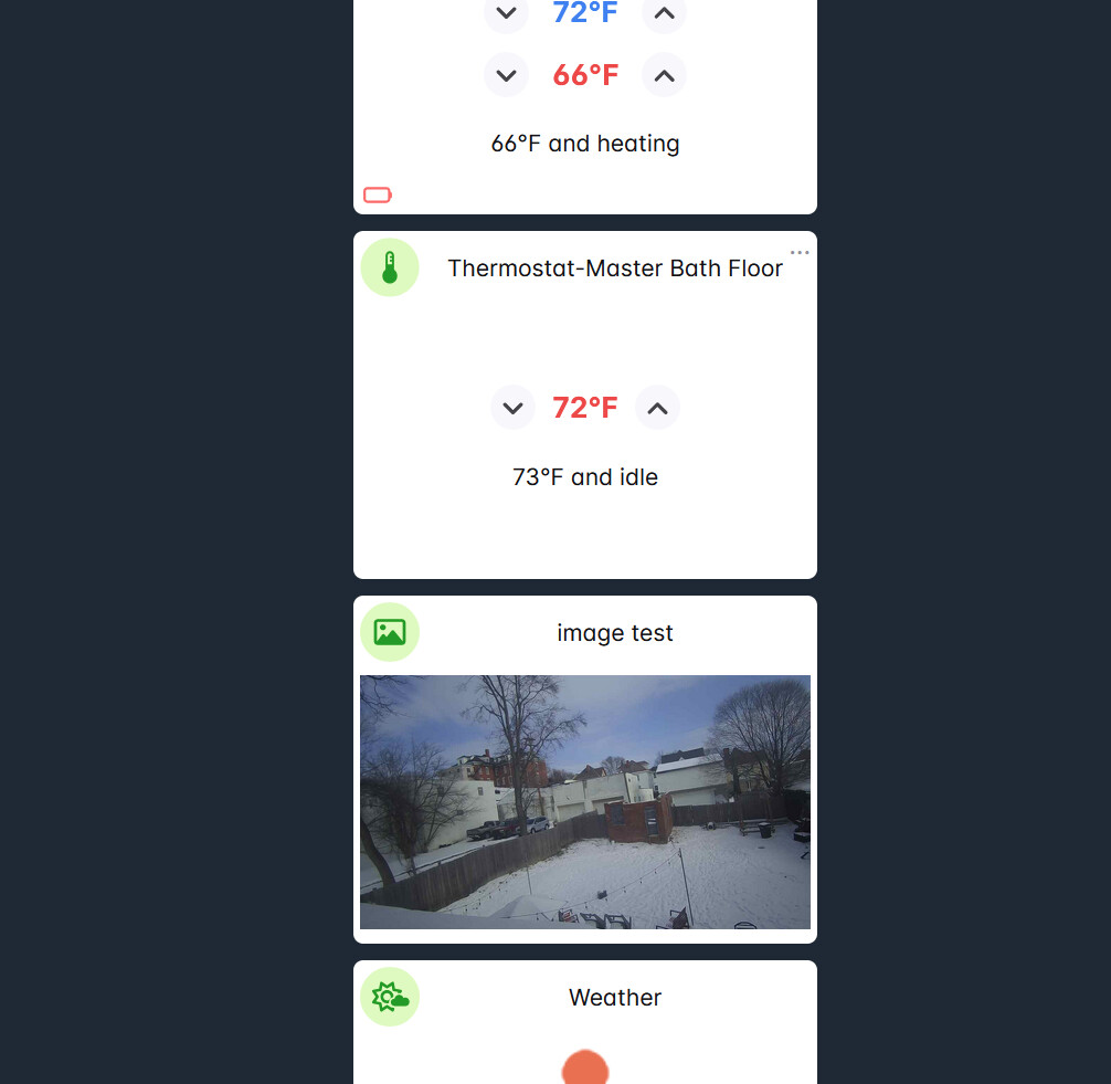

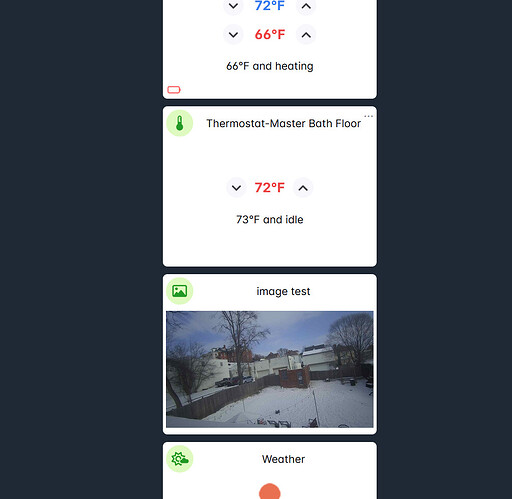

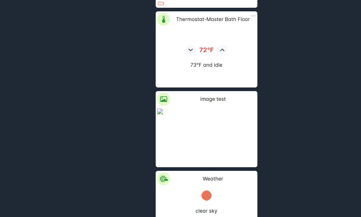

Using the chrome-based browsers, I can view the IP camera snapshots in a separate tab of the browsers but not in an image tile in a dashboard. Image tiles appear to only work in Firefox-based browsers. Is this a Hubitat bug?
Interesting. I normally use firefox but I can confirm this is an issue
Here is firefox
ez-dash
classic dash

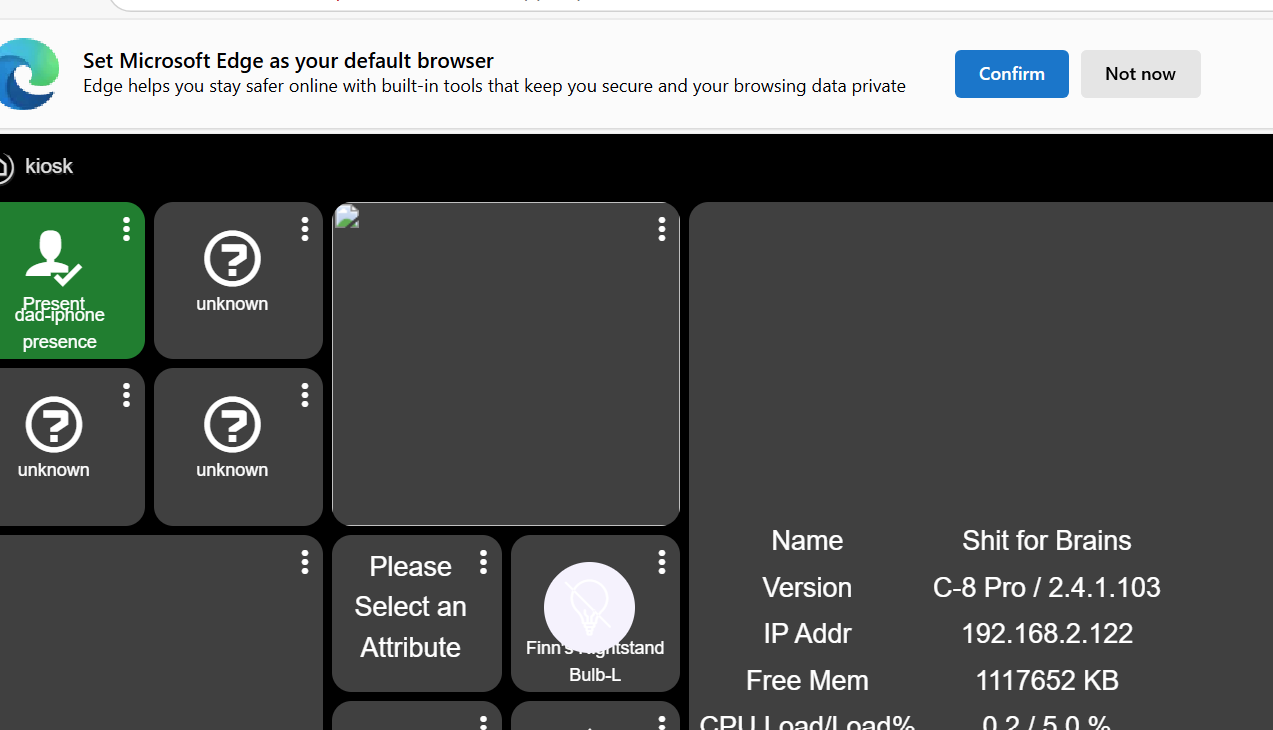

Here is Edge
