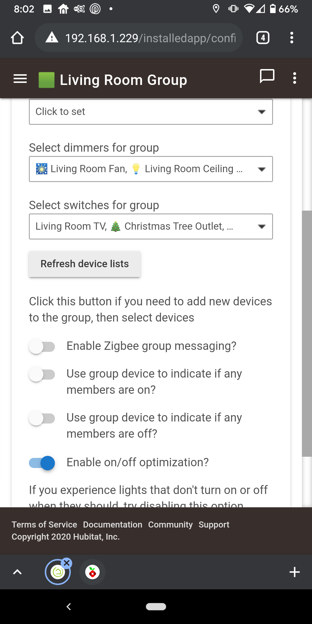

I created groups for each room. The groups come in handy for other stuff too, like if I leave a room and want to shut everything down in that room.
Enabling "on/off optimization" in the group made a big difference for me (probably not as good if you don't have plus devices). This just sends the on or off command to devices that are off or on respectively, thus minimizing unnecessary z-wave (or Zigbee) traffic.
Which is one of the main reasons I have mostly Zigbee.
Can you show me an example of how you grouped them?

Kinda hard to see from my phone though.
