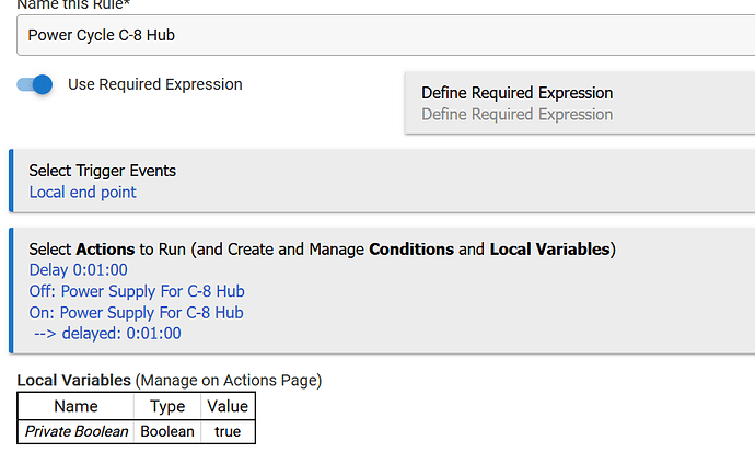

I've been using a minute in the rule on the C-7:
For a C8 you would need to at least double that. When I reboot my C8, then two C7's (in that order) the C7's finish in about half the time.
This is the power off time, to reboot the z-wave radio, not the hub.
