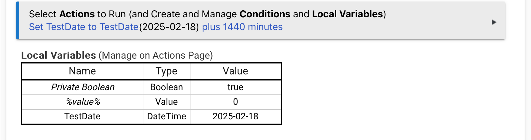

I tried Rule Machine, but unfortunately, date addition only currently supports minutes, and doesn’t work on a date only variable (Just tried it with the following rule):
Thanks. I'm aware of the non-date-only variables. I was trying to not use minutes, but I'll give this a try whenever I get some time.
