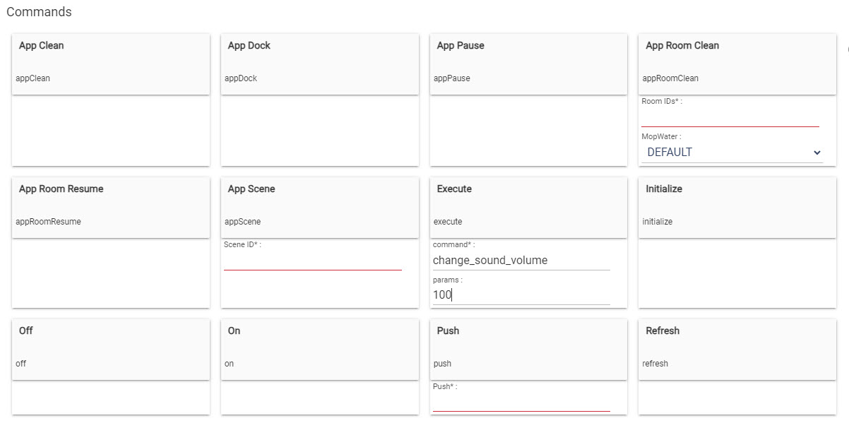

Background: I've got a device with a command (Execute) that takes multiple arguments:
The command works fine when I activate it from the device page, but I'm at a bit of a loss as to how I can trigger this command via Maker API.
