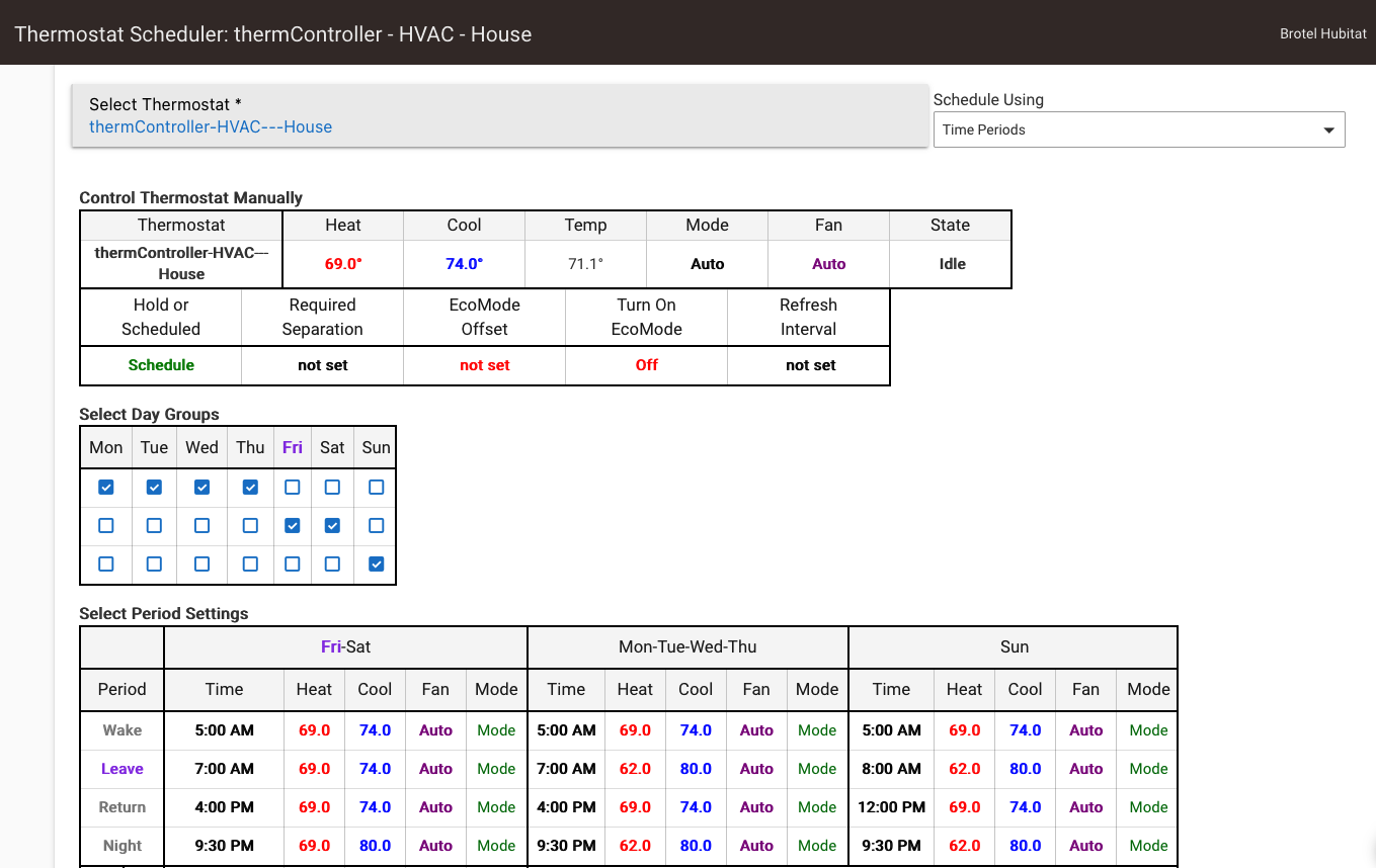

That's helpful. Thank you! Okay, I've started from scratch setting up the Thermostat Controller to control the HVAC - House thermostat. I also set up the Thermostat Scheduler to control the virtual thermostat created by the Thermostat Controller. I think I got it all set up correctly, but it's not behaving the way I expected. The current heat set point on the schedule is 69 degrees, but the unit is setting to 65.5 degrees in heat mode. I've attached some screenshots in hopes you can help me.
Looks like the controlling thermostat is reporting a temperature (71) greater than your setpoint (69). I wouldn't look much at the the controlled thermostat, as the controller takes over that, and it won't always appear how you expect if the controller doesn't actually need to do anything.

Yes, it can. If you see the screenshot of the scheduler page, Mode is all the way on the right of each day range that is configured. I have the following options for mode when selecting it:

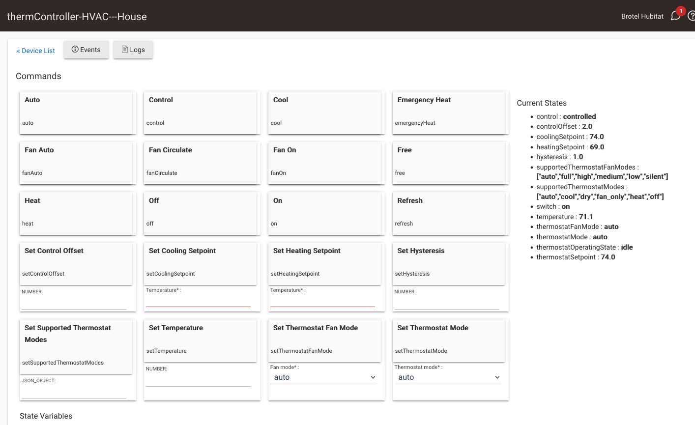

In your screenshot, you have a cool and a heat setpoint. When the mode is Auto is it not using both setpoints?

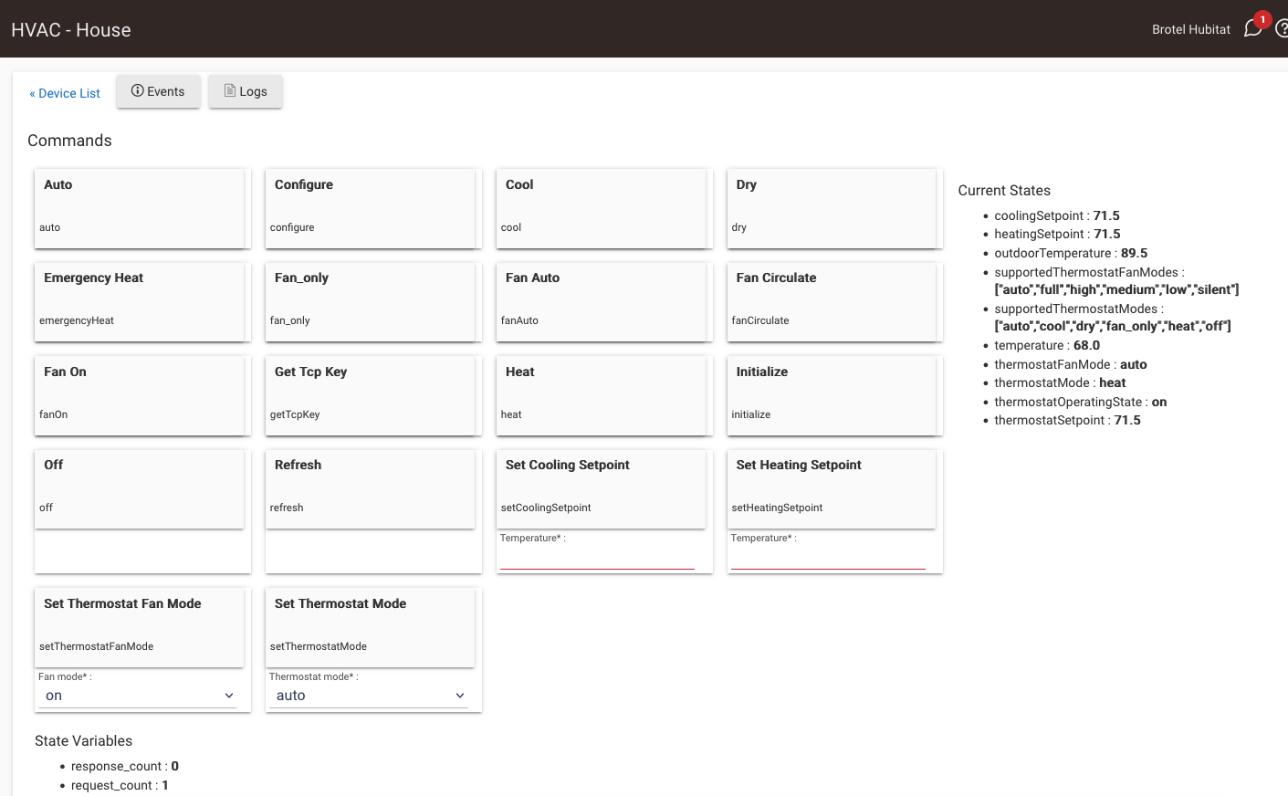

When using the Thermostat Controller app, the unit's thermostat simply takes the latest setpoint (heat or cool) as the setpoint. It functions the same whether it's in heat, cool or auto modes on the unit. In the screenshot below, I set the Thermostat Controller the heat setpoint at 69 and the cool setpoint at 74. The screenshot is what it showed on the device page after setting those setpoints.
That is the device page for the actual thermostat, not the controller, correct?
Here is my actual tstat device page when the controller is in auto:
And how it looks on a dashboard with the physical device on the top and the controller device below it:

When in cool I only have one set point showing:
I recorded a screenshot video to show the behavior I'm seeing: Dropbox - Screen Recording 2023-05-08 at 8.06.33 PM.mov - Simplify your life
The unknown for fan mode looks to be an issue to me and could be part of what is messing this all up. We have passed my level of helpfulness so I am tagging @bobbyD to see if he can help or point you in the right direction.
