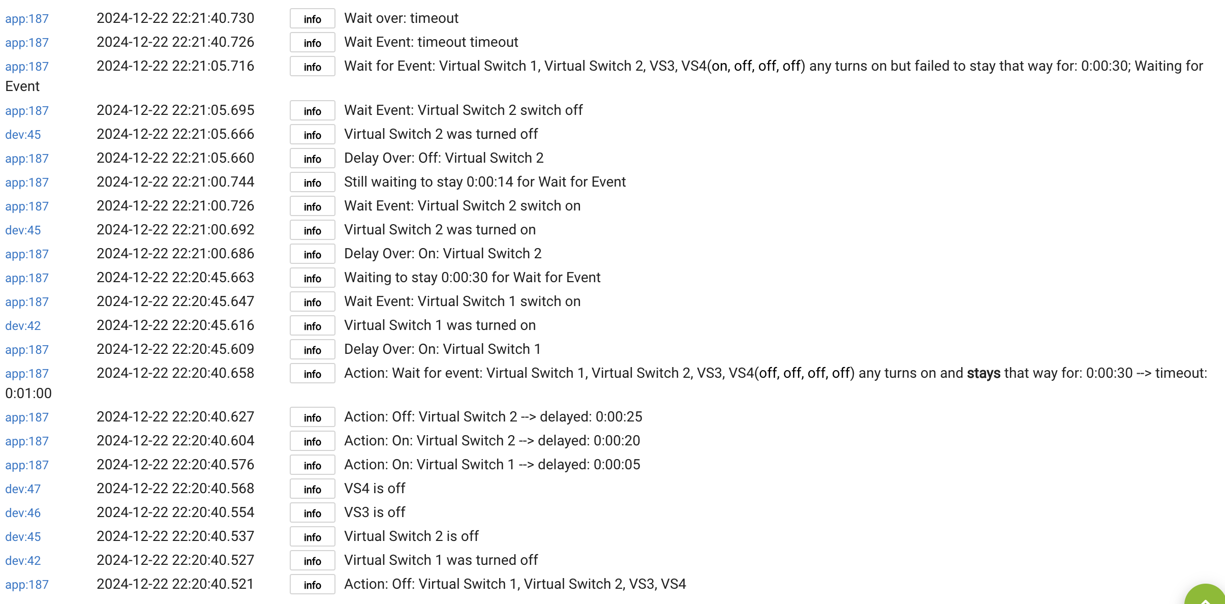

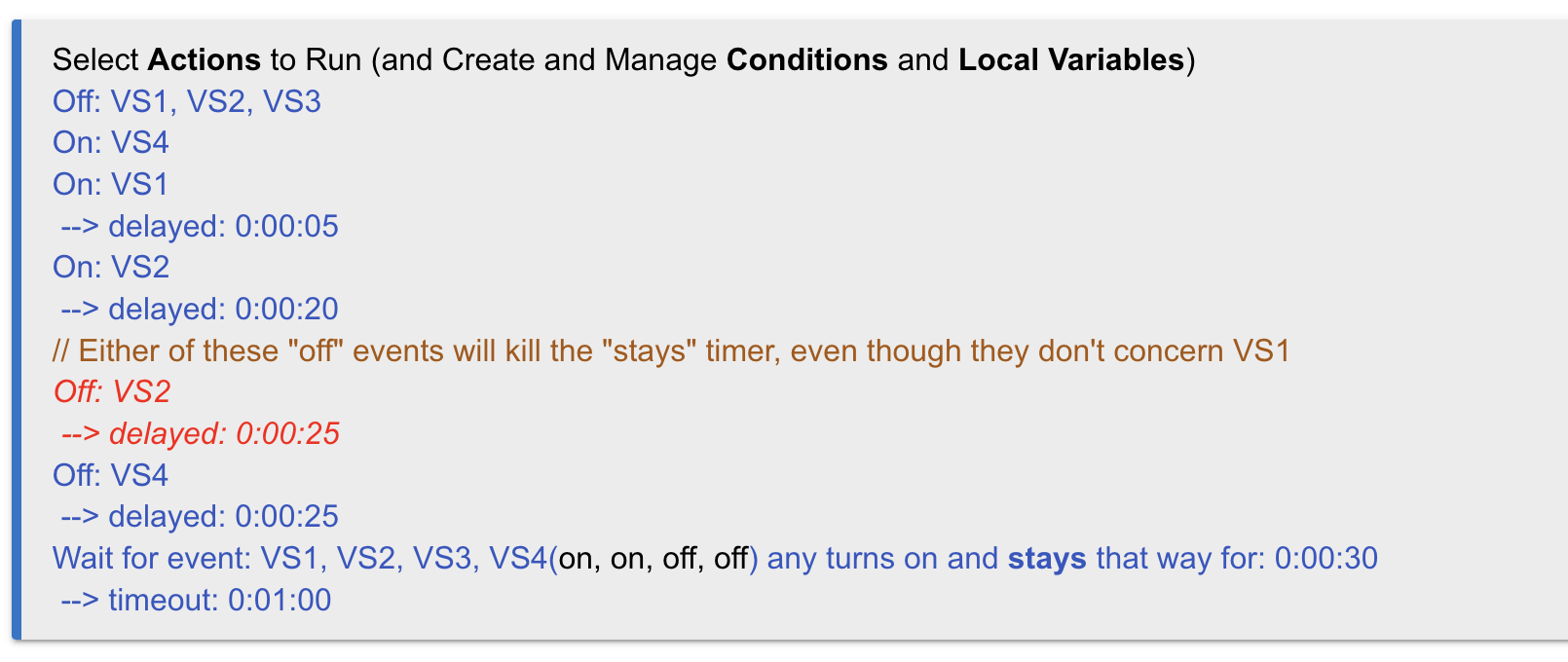

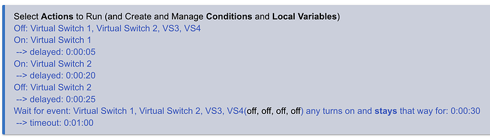

Here is a test rule to demonstrate the behaviour in question:
In this example, "Virtual Switch 1" will turn on and stay on for more than 30 seconds, but because Virtual Switch 2 will turn on and back off during the "stay" period, the Wait will fail to complete and ultimately time out.
Is this behaviour as designed ? I was expecting "any" of the devices staying for the whole period satisfying the wait/trigger.
Turns out that if any of the switches that are part of the wait have an on-to-off transition during the stays timer, it will fail, even if the switch that started the stays timer actually... stays.

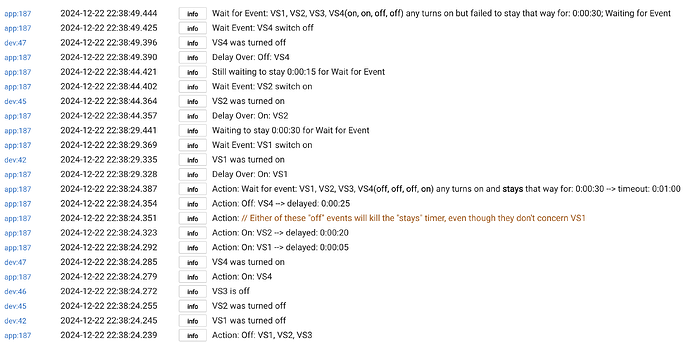

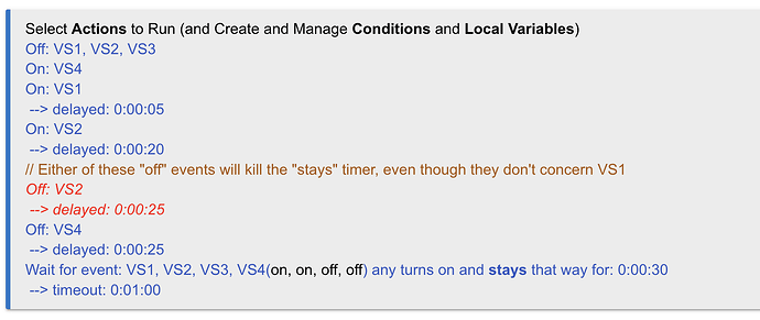

Looks like splitting up the devices each in their own event with stay doesn't change the behaviour. Good to know, but then the wait action doesn't read the way it works:
