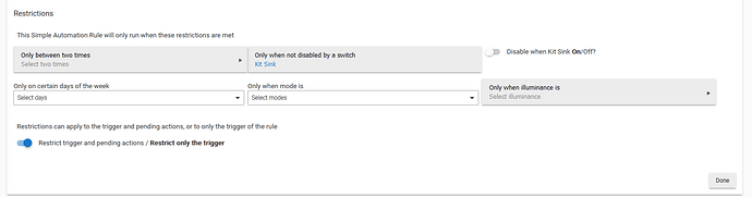

I was just fooling around with this, and found that if I have the switch restrict only the trigger, with the switch's on position be the restricting switch, this will allow motion to be disabled after turning on the switch.
Of course, there may be times when you want to keep it dark-my original method might be better there.
