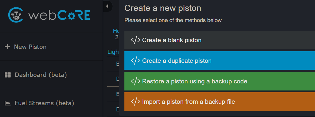

As long as your separate WebCore backup was after your 3 days old backup just go into WebCore.
Select New piston and Import; point it at your WC backup file.
You will get a list of all your pistons to import.
Remember to rename your current one after the 3 days old restore as WC does not like to import a piston from a file with a duplicate name.
Can I import all of my webcore pistons at once? I changed so many pistons during that 3 days that I cannot remember which pistons I modified.
There is a “last edit” date on the pistons in the import file so that may help.
I don’t think you can bulk import.
Years ago when I migrated from external WC app to the internal one I recall having to import each piston.
