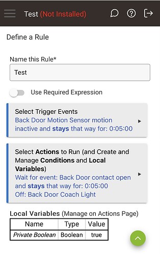

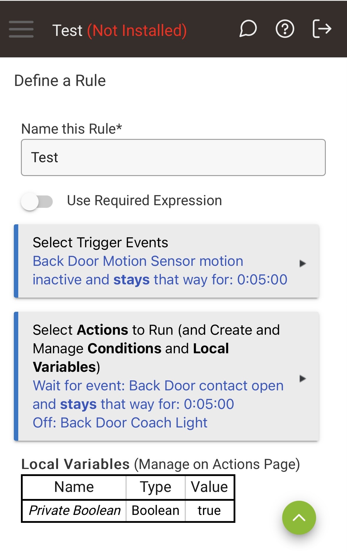

Still hard to say for sure without any screenshots, but it sounds like you’re trying to add multiple triggers to your rule.
Triggers are always an “OR” thing, as far as I know. Any trigger added to the rule will cause it to run.
If you want to impose multiple conditions on the actions of a rule, you’d need to include a required expression (which is in the trigger section of the rule configuration screen), or add your second wait condition to the rule’s actions.
Here’s an example that could accomplish what you’re trying to do. There are other ways as well.
