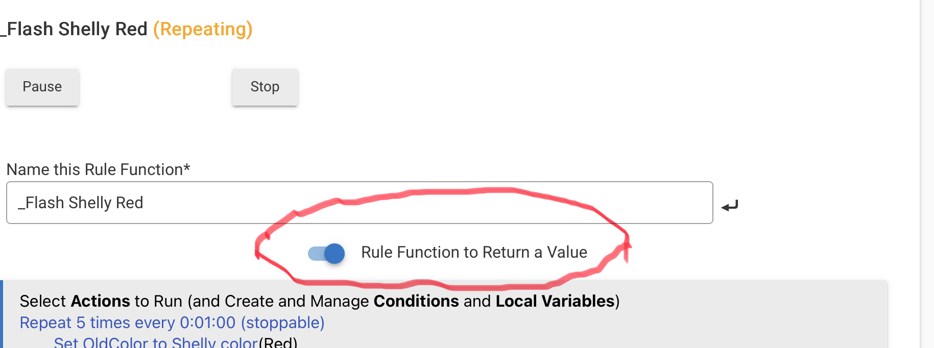

How do I find “Rule Function” callers?
I created a rule function that flashes my Shelly plug red but I didn’t document where I placed the calls to the function.
What’s the easiest way to locate them?
Try @thebearmay's Rule References Rules Table https://raw.githubusercontent.com/thebearmay/hubitat/main/apps/ruleRruleList.groovy
It will generate a table of rules and which rules reference them, and which other rules they reference.
