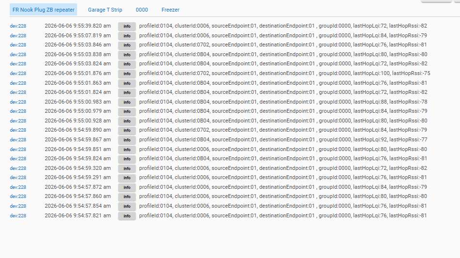

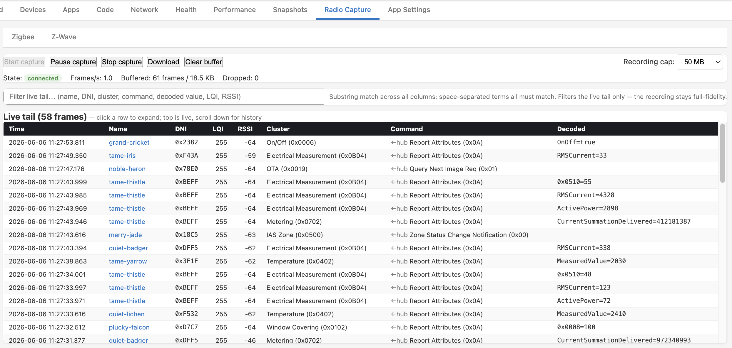

I just sent an off command to the plug and was surprised it generated so many log entries. Is that indicative of poor comms and a lot of retry messages?
The smart plug is 25’ from hubitat (on the same floor) and just around a slight corner so not pure line of sight.
Is this normal for Zigbee? Anything jump out from this data? If zigbee is fragile I really don’t want to wade into it much further.

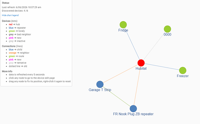

p.s. I have no idea what node 0000 is but it shows up.

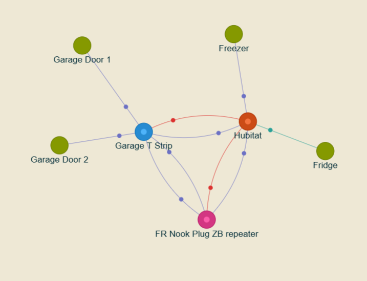

Using the app referenced in this topic, you can see what the device is chatting about:
Is this a power reporting PR plug? If so, disable/minimize any PR options that you can live without (which may be all of them).

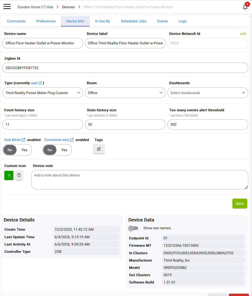

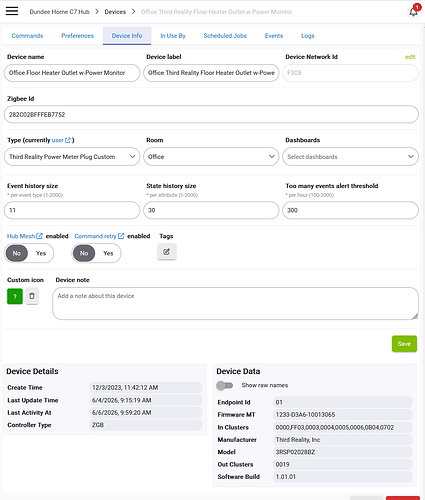

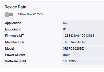

Is the plug’s firmware up-to-date (at least in terms of what Hubitat has available for it)?

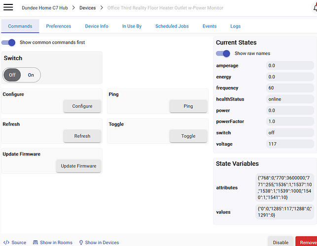

I notice you’re using the generic driver. No issue there but I have 15 of these throughout my home and I moved to the community driver called Third Reality Power Meter Plug. The OTA firmware works I feel better with the Community driver too.

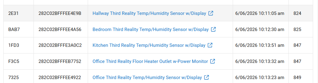

Heres the msg count for 24 hrs.
I switched the driver as I wanted the Power features, which this unit provides very well.
