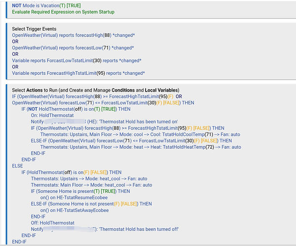

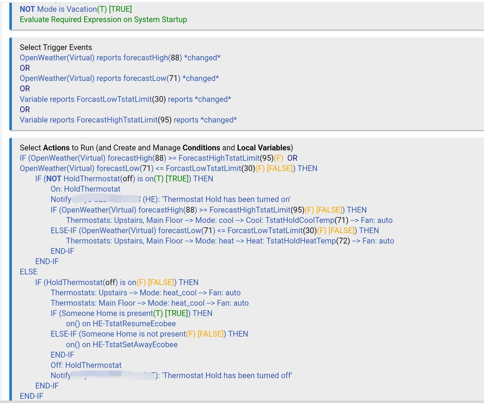

Here is how I do it. I have global variables that I use to adjust my limits on the fly
Click to See the Rule in RM
The "HoldThermostat" is a virtual switch that I used to use to manually trigger the hold.

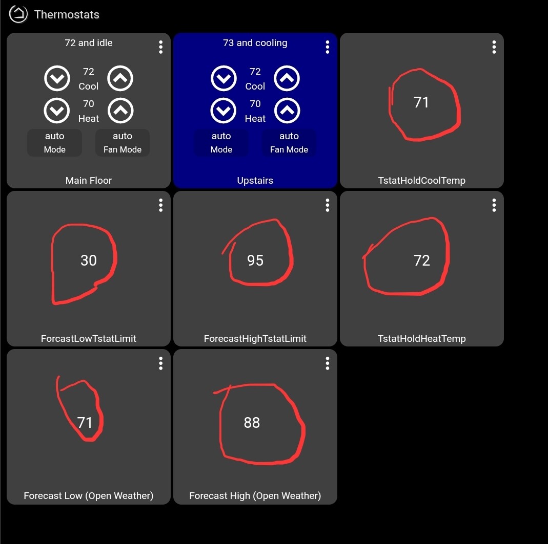

Click To See Dashboard with T Stats and Hub Variables
Uses the following Variables used in the Rule
TstatHoldCoolTemp - The "hold" temperature I want set on the thermostat when it is hot outside
TstatHoldHeatTemp - The "hold" temperature I want set on the Thermostat when it is too cold outside
ForecastHighTstatLimit - The temperature limit for determining it is host enough to trigger the hold
ForecastLowTstatLimit - (mispelled when I created the variable though) The temperature limit for determing is it cold enough to trigger the hold
Not Variables - but wanted to see them on the dashboard
Forecast High and Forecast Low - I get them from Open Weather, but you can also get them from Wunderground if you have an API.

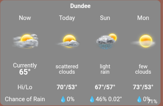

What is the difference between:
  • Tda Temp Max
  • Today Temp Max
One has 85 and the other has 79
its stupid - my attribute names already are so long I had to do something! Its is Today, Tom for Tomorrow, and TDA for The Day After - for the 3 day forecast. TDA is TheDayAfter Tommorrow.
FYI - 'Now' is referred to in the attributes as 'current'.

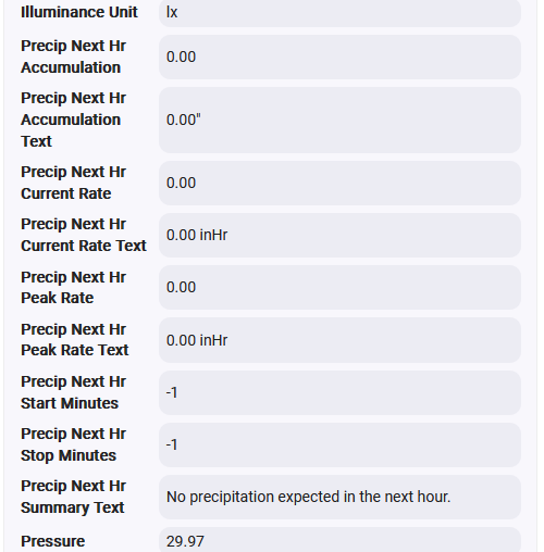

In case you're interested - I recently worked a bit to add minute by minute precipitation. This covers forecast for the next hour. It's not in the main build of this driver at this time but it may possibly well be. Let me know if that is something that affects your rule building or needs. This are the values that are currently in a dev build that is being looked at by others:
The precipitation additions won't help me much currently.

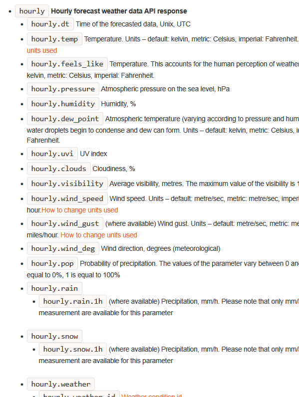

However, if you do get around to adding Hour By Hour forecast temperatures, that would be great.
Something like Today's Forecast at XX:XX for each of the 24 hours would be awesome.
