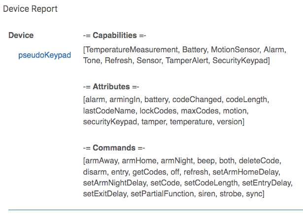

I wrote this App to help me find the Capabilities, Attributes and Commands of any driver:
GetAttributeApp on github
You pick devices and it creates a "Report" that looks like:
Thanks for the App csteele. I will go thru it to figure out what you did but the results really helped. As I go thru it I am interested to know why the capabilities from the report had a capital letter starting them out but I had to change all of them to non-capital to work? besides that it was exactly what I needed... and now i get to digest your App and figure out exactly what you did... thks again. It turns out the app i was writing for the Aeotic MultiSensor 7 won't need to be completed! That device will be returned. The motion sensor is stuck on reporting ACTIVE and I have read from others that is what they are getting. I will return it and see if I can get coverage for its functionality with one or more sensors. I am wondering how good Aeotic's QA can be seeing how they shipped me the device with the wrong batteries!? They provided me with CR2's that are about 25% shy of width instead of CR123's.
