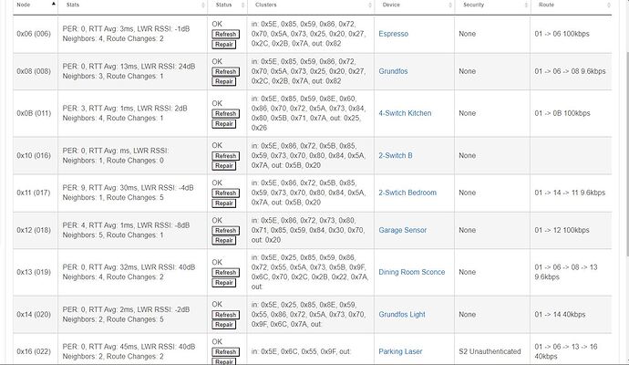

Take a look at your Zwave \ Settings page and maybe post some screen shots of it here.
Look at things like security pairing, RSSI and even device speed as indicators of your mesh performance.
Can you list your repeating devices, and approximate distances they’re apart / from the hub ?
Remember a goal of a Mesh is to ensure there are multiple paths back to the Hub.
Thanks for the suggestions. This is a page that I had not looked at, but it does have some interesting information. In looking at the Topography Map, I'd have expected it to be somewhat more connected given the short distances. Also, I note that the problematic item is a single hope with good speed.
I've added a rudimentary map of devices and distance in the house, the list of devices and paths (most of them are in the image) and the topography map.

I do not consider myself to be among the "very knowledgeable" but I have managed to produce a decent Z-wave mesh in my home. I have 21 Z-wave devices. Of those, 15 are connected at the full 100kbps, 4 are connected at 40 kpbs and 2 are connected at 9.6 kbps. One of the 9.6 devices is in the corner of my basement and has a lot of interference. The other device is a motion sensor on my back deck. There is a brick chimney between the hub and the sensor, so it routes through a repeater that is further away. Thus, I know why those specific signals are not robust.
You have one device with no connection at all. Three of your devices are connected at 9.6 kpbs, two are connected at 40 kpbs and three are connected at 100 kpbs. Thus, you do not have a very strong mesh.
You have three devices with strong connections to the hub. 0B is a switch that I assume has repeater capabilities. However, nothing is using it as a normal signal path. 06 is the plug that controls you coffee maker. It is serving as a repeater.
The other strong connection is with the garage sensor. However, that cannot function as a repeater since it is not mains powered. If you can add a Z-wave repeater/range extender somewhere near the garage sensor, it might help your mesh.
I think part of the problem may be the order in which your devices were paired. Typically, you start by pairing those devices closest to the hub and then pair those that are further away. The lower the device number in hexidecimal, the earlier it was included. However, you indicate that device 08 Grundfos is a considerable distance from the hub. Yet because it was paired early, 13 Dining Room Sconce is attempting to use it as a repeater. The sconce does not have a good signal. If it were attempting to connect through devices in the kitchen, it might be more successful.
You have some other devices that should be able to serve as repeaters such as 011 2-Switch Bedroom. Because it is not getting a strong signal, it is not effective in this role.
I know this is going to sound daunting, but I suggest that you exclude all of your Z-wave devices, reset the Z-wave radio and then go back and include your devices one by one starting with those that serve as repeaters. Begin with those closest to the hub and work outward.
Although switches do serve as repeaters, if they are installed in a metal switch box, they may not be ideal repeaters. You may want to purchase some Z-wave plugs with repeater capability or even some dedicated Z-wave range extenders to strengthen your mesh.
I purchased four Aeotec Range Extender 7 devices for my home. They made a big different in the integrity of my mesh. Placement of repeaters is also important. Do not underestimate the importance of adding devices to your mesh in optimal order so they will connect to the best nodes.
If you have to bring devices close to your hub for inclusion or you have to bring the hub close to the devices as in the case of permanently installed fans and switches, remember to allow them to find a suitable path once everything is returned to its normal location.

0x11 2-Switch Bedroom is at the "end of the line" in the sense that no other devices are beyond it away from the hub. In fact, only the problematic Ox14 Grundfos Light and the 0x11 2-Switch bedroom are in that direction. Everything is in the other direction from the Hub and, while the network is pretty weakly connected, as you say, all the other stuff (including the far away Grundfos circulator with 9.6kbps rate) works reliably. It's just the 0x14 Grundfos light (@ 40 kbps) that fails. This really is close enough that it should have a higher rate. But there a number of intervening walls.
Not sure why the Ox0B 4-switch kitchen is not acting as a repeater. it is ideally positioned for that in the physical world.
I could redo it all (and maybe I will). But with only one flaky device, I'm not quite right ready to re-pair them all. Maybe another outlet between the Hub and the problematic 0x14 Grudnfos light would suffice?

Remember that having a repeater device at the end of the line is not necessarily a problem. It might be a good thing. It is not just the physical distance that RF waves must travel, but the environment through which they must travel. Sometimes, a device will connect to a repeater that is much further away physically, but which has a better transmission path.
Ideally, you want all "mission critical" devices to have a 100 mpbs connection. They may work with a lesser connection, but the chances of failure are greater.
By the way, if you have physically removed a device from the mesh, it is best to exclude it from the mesh so other devices won't looking for it.
Yes, especially repeating devices. Why not just leave it plugged in somewhere as a repeater (if it is a plug-in device)?
I had thought about an intervening repeater above, and it makes sense to use that device. The only intermediate outlet would be in the laundry room and be somewhat behind the washer, in the same duplex plug, so not sure if that would impact its performance.

Remember that a repeater does not have to be plugged directly into an outlet. I have a couple of repeater devices that I plugged into extension cords so that I could locate them in suitable positions for good signal paths to and from the device.
Plugging the repeater into an outlet that is immediately behind a large metal object such as a washer or dryer is far from ideal.
Also remember that signals travel vertically as well as horizontally. A repeater on a different floor, in a basement, or in an attic might also be an option. If possible, try to get the repeater above objects like furniture and appliances that will interfere with the signal path. For example, in my garage, I mounted a repeater about 8 ft off the floor using an extension cord so signals to my garage door sensors would pass over the top of my vehicles. Use your imagination; think like a radio wave.
Hadn't thought about the extension aspect. And the washer is definitely non-ideal, I agree. Just thinking about things in the path, this is the best location. We are single-story, so Z-axis is not helpful to us. There is a bedroom along the way that is in less of a direct-line, but the outlet is unobstructed. Cuts the distance some. Really the only other viable option, unfortunately. The Hub and problematic item are really not that far apart.
