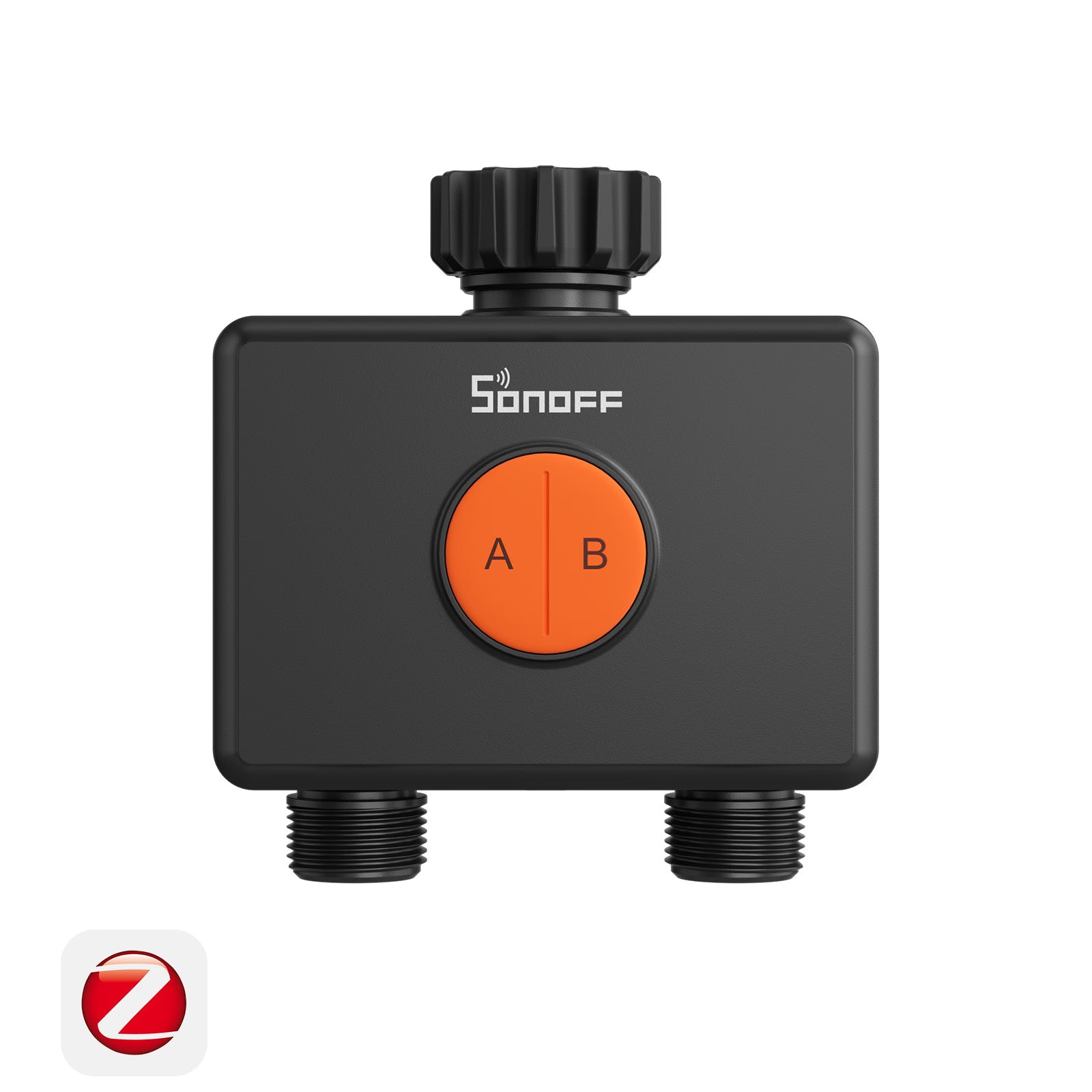

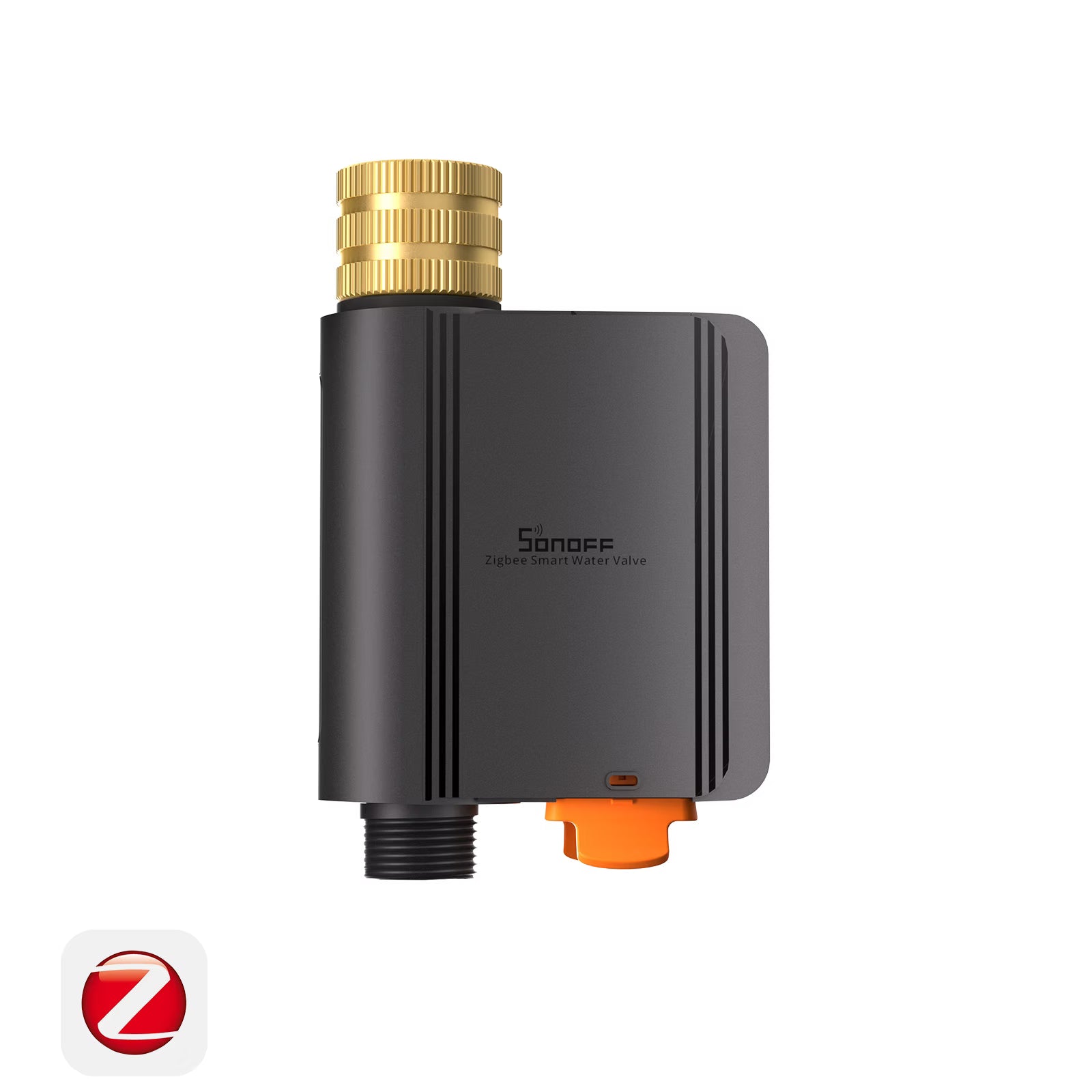

There are several zigbee hose timers that are controlled directly by Hubitat. Sonoff alone makes these three:
There are also several Tuya zigbee hose timers that work with Hubitat.
I have both Sonoffs the Duo & One, both work well and are solid. takes 4 AA batteries

+1 for Sonoff. ZigBee, works well, four AA batteries last the full gardening season in northern OH. The new brass connector version is not currently on Amazon. That said, I’ve had no issues with the plastic hose connections.
Note: when ordering there is a US and an EU version of the hose threads.

What driver did you use for the sonoff dual Valve? I just got a couple and the only sinope driver only has one valve switchable.
do you know how to load 3rd party drivers? What hub do you have?
Actually, I think I figured it out. It's clunky and not very elegant, but it works. I loaded the tuya 3rd party driver on HPM. Running a C8 and a C7 (mesh'd). It's working reliably, but I do wish hubitat cared a little more about driver inclusion.
