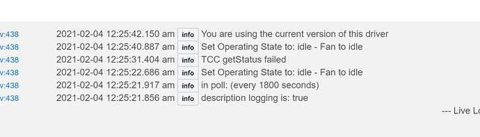

I mean, it works, but it just logs like crazy. It was one of those previous couple things you added in the past few weeks.
No reason to believe the database is corrupted. And there was a lot of platform updates as well as at least a couple TCC app updates while this was happening.
doesnt seem to be working.. you should have the polling and set operating state messages on every run.
just comment out the single call on yours to the gethumidstatus for now if you cannot get the variable ironed down. see if that helps in the short term.
None of that logging, or at least not consistently. But I click on the dashboard, or within the device's settings page, and the thermostat responds. The dashboard reflects setpoint changes that you do via the actual thermostat.

Is there a way to access another way? While testing this I'm getting "You have exceeded the maximum number of attempts. Please try again in a few minutes." If I try to login to TCC via a browser and the changes stop working when I run one through a virtual device. Thanks! (I never had that problem with ST.)
I think @kahn-hubitat had a custom version he uses to retry in 5 minutes on those failures. TCC rate limits their connections. SmartThings had a backdoor to TCC that didn't get rate limited.
If my memory is correct, setting the poll interval in the driver at 15 minutes will eliminate most of those errors if your not using the TCC app a lot. I used to use 30 minutes and never had an error.
