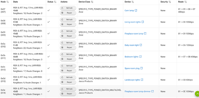

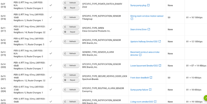

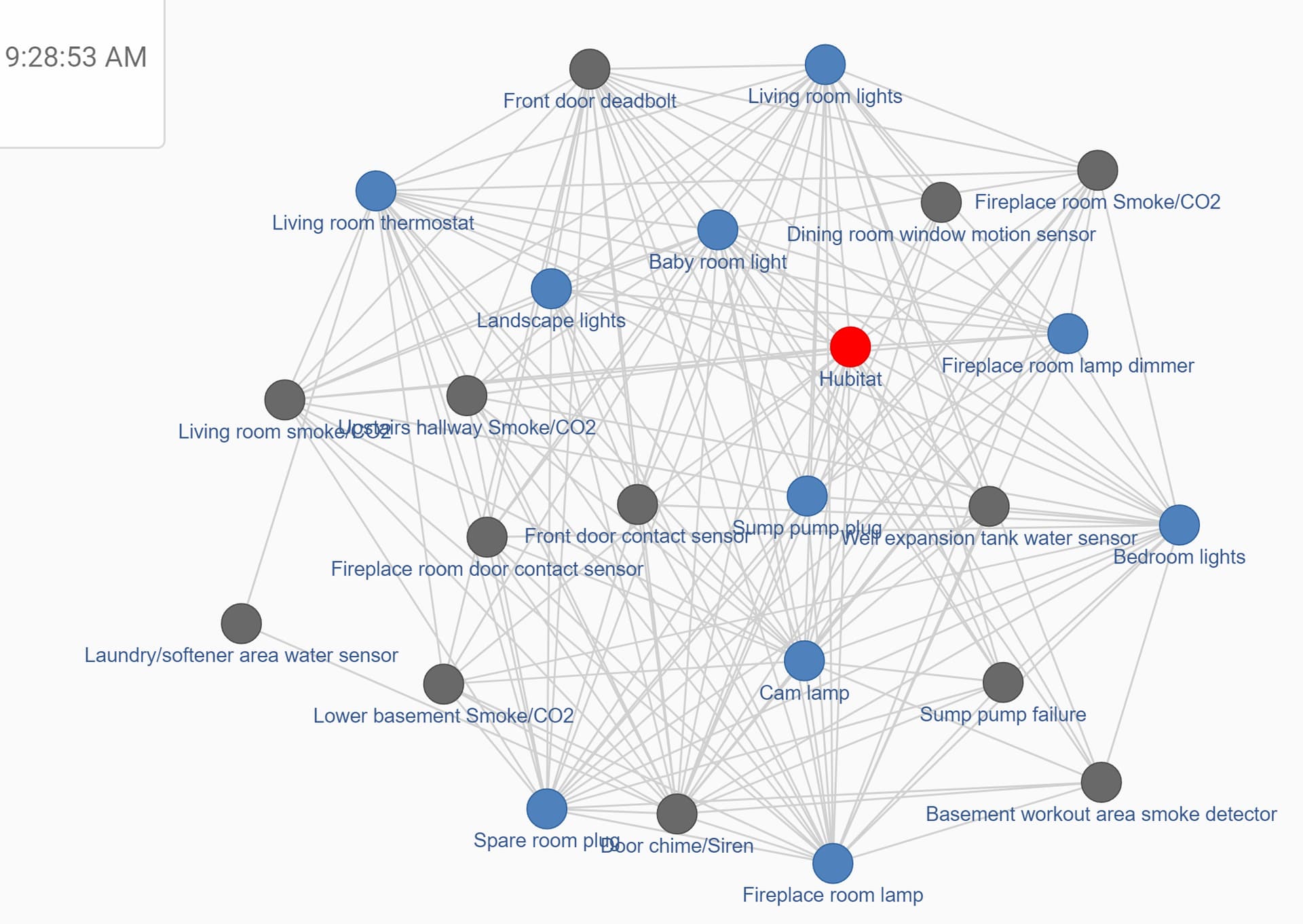

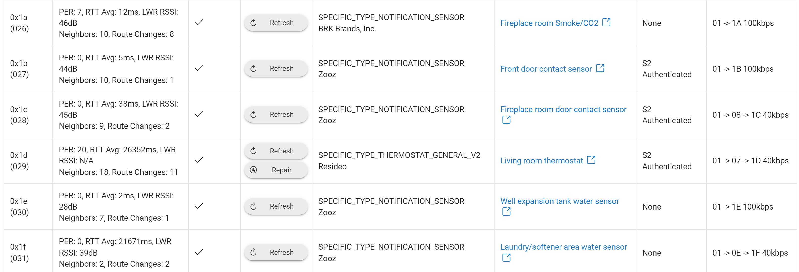

I'm on a C8 hub, and everything else seems to be functioning correctly. It doesn't look like any z-wave device has a high number of route changes, the most shows 8 and is a non-repeating first alert smoke/CO2 detector. I'll include some screenshots.

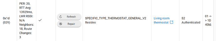

I see your T6 is paired with S2 security. There really should be no need for that. Try removing and adding back without security. I have 2 T6 thermostats and both are paired with zero issues without security.

Can you post your z-wave details page in its entirety? Use windows snip to do it
