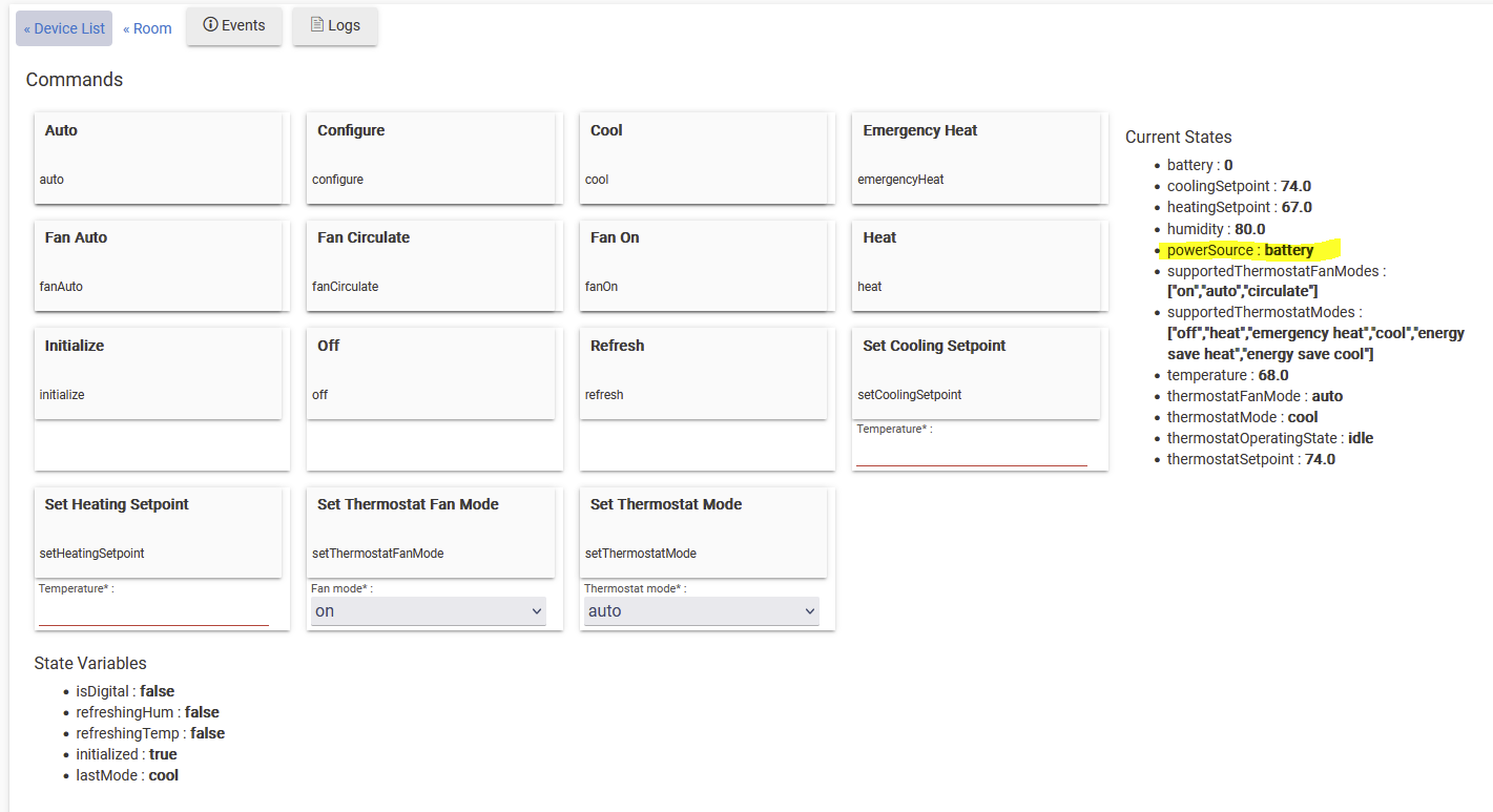

When I first connected my T6 Pro z-wave I had batteries in it for reasons I don't recall. I didn't realize until later that if you had batteries in it when you paired it, the power mode would stay as battery even if you removed the batteries.
I tried excluding the thermostat, removing the batteries, checking that the Power Mode on the thermostat read as 24 VAC. But when I re-paired it, it still thinks it's on battery power.
I'm currently using the Generic Z-Wave Plus driver, but I've tried both Advanced T6 drivers and no change.
Hub: C5 v2.3.9.18

I had not. I just did, refreshed the page, and nothing changed.
Have you tried switching the driver to plain "Device" and then using its options to clear current/all states, and the switch back to normal driver?
That battery entry may just be a leftover artifact, but I have no experience with this device so I'm not certain. The "Device" trick won't hurt anything though, so perhaps worth a shot.

I hadn't heard of this before. Tried it, and the "powersource: battery" state went away entirely. I could tell that the Hub was holding on to that old setting somehow, but didn't know how to get rid of it. Thanks!

In case anyone else has this same issue later, the problem seems to be with the Advanced Honeywell T6 Pro Thermostat driver. I played around with changing drivers, and the "powerSource: battery" state only showed up after I changed to the Advanced driver. And it still says it's on battery. Must be an issue with that driver.

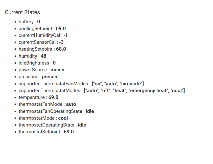

That said I use the advanced driver and it's fine. Here is my T6
Note: I do have to change batteries
