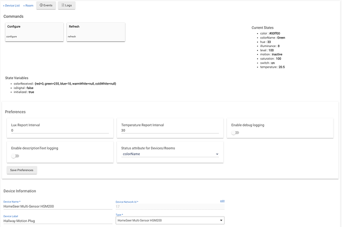

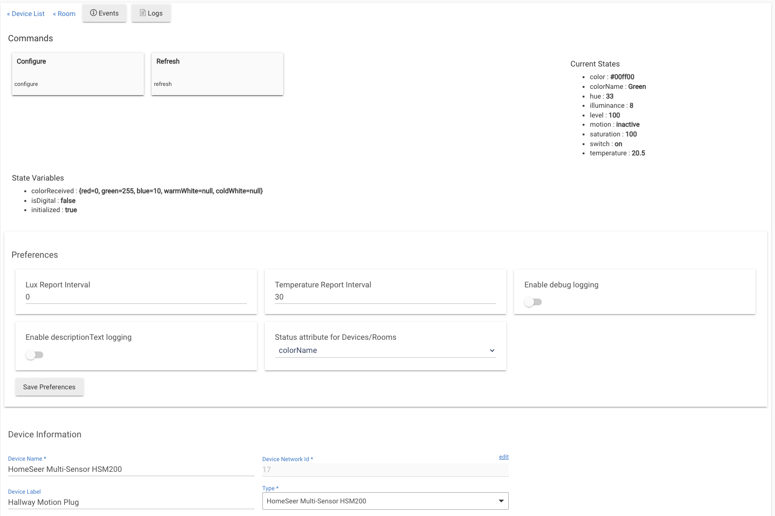

Here is my driver.
@philippompili want to give that one a try? Looks like it should have the color commands.
ya it does i use it for motion in the bathroom etc.
one thing to note it is not true rgb.. so some colors come out as others.. i know pink purple orange red blue and green work
This is great. Working just fine, and it looks like the logs are error free as well.
