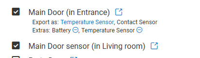

the main door sensor its a virtual device to be able to be seen in alexa, but not on homekit for some reason....
and for some other reason they all show up on temperature on homekit, but just the patio door and window show on homekit as contact sensor....
What device driver are you using for all of these devices? When I export a contact sensor, it initially gets placed into the same room as the Hubitat in Apple Home. I need to click into the Room as the contact sensor is not available on the main page.
As for the Main Door Sensor, if you cannot find it in the room, click the "switch" button. That would export the Main Door Sensor as a switch rather than sensor.
As for all the other devices, my suggestion would be to click all those "-" categories in the Extras section. This way, only the main device would be sent to Homekit rather than the main function and its associated readings.
