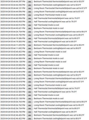

Test 1: In HK set all thermostats to 89 manually, then trigger the automation which should set them all to 83
  • The thermostats get set to different temperatures and only one is 83
  • Trigger the automation a second time (without doing anything else) and same result but different log text
  • Notice the log entries are 'out of sequence'. It shows the Bedroom getting set to cool, but then all the logs are for the other thermostats, then it shows the Bedroom temperature setting. This looks like a race condition if I had to guess??

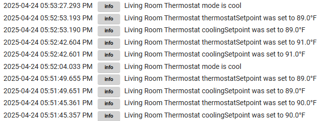

Test 2: Set single thermostat manually, then trigger automation for setting 1 thermostat
  • It doesn't show in the log that it set it, but it actually does
SingleThermostat89 then 83
I did other tests, but didn't pay attention to the logs. In general things don't work regardless the various settings.
I did some additional testing and having the automation trigger with only setting one thermostat sometimes worked and other times set the temperature to some random number.
