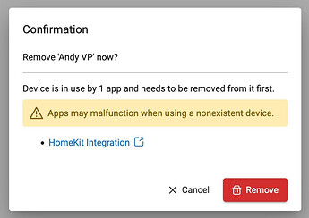

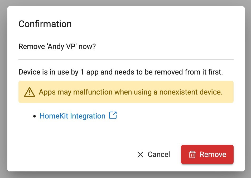

That's it. To test I create a Virtual Presence sensor and enable HomeKit. Save it, then I head over to Apple's Home app and it never appears. Furthermore, it doesn't appear in the HomeKit Integration app either, there's not even a Presence section. When I go to delete the device it complains that it's in use by the HomeKit Integration.
