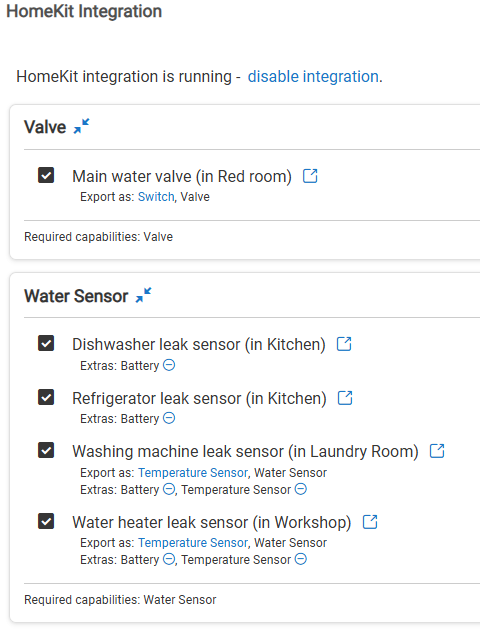

I wonder if there's a capability listed in the Aeotec driver that isn't in the Zooz one and so Homekit doesn't list them when setting up the automation on the Home app.
In the Homkit Integration enable the Advanced option at the bottom and then post screenshots of the two different devices from the list in the integration app.
Here are the details. Perhaps the difference is that Hubitat sees the temp sensor capability in the downstairs Aerotek Zigbee units but not in the upstairs Zooz Zwave units?
I think you are right, when you see those sensors in the automations list it is picking up the temperature. None of my leak sensors show up in the automations app. However if I go to the sensor itself I can add an automation from there.
