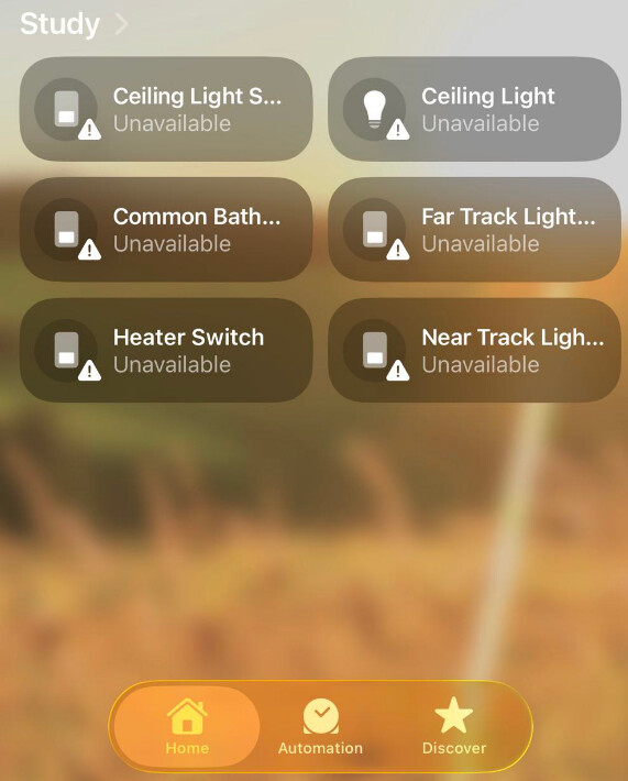

Hi all,
After installing the built-in app HomeKit Bridge, and successfully connected to my Homekit, devices on Home app have been rather unstable - frequently showing unavailable status.
Is the built-in HomeKit Bridge not the ideal way for a stable Hubitat-Homekit connection?
Are there any workarounds?

Are you running the current version of the Apple Home architecture? The old version wasn't very stable with bridges.
my 2 cents on this issue, every time i have seen it on my network it’s been an issue with MY network and not hubitat. On my AP if i enabled DHCP Offer Broadcast to Unicast and ARP proxy it WILL cause this issue and it was β€œfun” tracking this down and were both enabled by default.
I would recommend starting with this support article and if your AP/Router has any settings to mess with broadcasts or ARP, turn them off. It Also cant hurt to reboot your AP/Router.
hmm, I don't see an update under Home, but it should have been the latest given I update all apps regularly
you are right. I switched to Wifi on Hubitat, and there is no longer any disconnections on Homekit. it seems to be a problem with (i) either my lan port (currently at a temporary location, which I will eventually move the hub to a different spot with a new lan port), or (ii) data cable that connects from port to hub (easy to test but I shall stay on Wifi for now until I make the actual location shift), or (iii) ethernet port of the hub (hopefully not).
It's not an app version. It was a manual migration introduced a couple of years ago. Depends upon when you set up your home.
In the Home app, look in Home Settings -> Home Hubs & Bridges. If you see an "Active Home Hub" then you are on the new architecture. If you are on the old architecture, you will likely see a warning about that.
