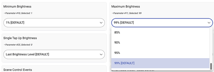

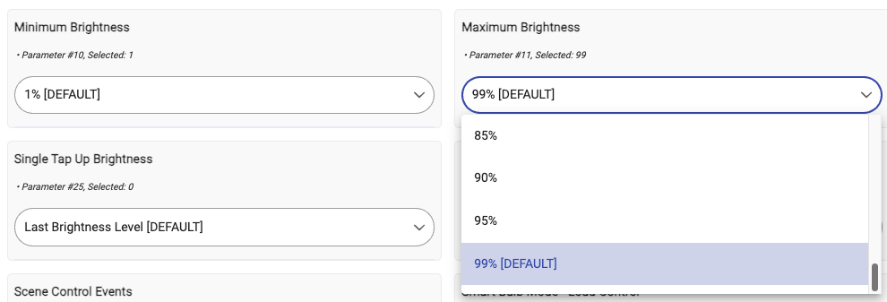

Looks like the 2.4.1 update fixed the dimming with one exception. I can say set X to any percentage from 1 to 99%, however voice commands to Siri to set the brightness to 100%, maximum or full brightness are ignored.
I am wondering if this has to do with several drivers (such as the Zooz drivers) having maximum brightness settings of 99% (see below). I see the same behaviour on devices that don't have this parameter though. It's frustrating to not have an easy way to tell Siri to set a device to maximum brightness though other than saying 99%. I know this worked before on a previous firmware.
That is due to Z-wave specs maxing the level command out to 99. Most drives (mine included) will still take a setLevel 100 command and then quietly set the device to 99, while at the same time posting the event that the level is 100 (so it shows full on dashboards, etc...)
You could turn on trace logging for my driver, then using Siri set the level to something other than 100, and then try setting to 100. See what results in the logs.
Here is what a see. I issued 2 commands:
  1. Set the study sconce to 25% @ 14:58. This worked successfully.
  2. Set the study sconce to 100% @ 14:59. Nothing happened, but there were some logs generated.
