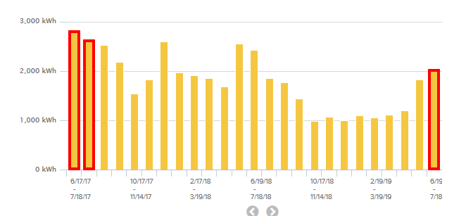

I'm in Oklahoma, and the house has VERY poor design of the HVAC setup as I describe above, insulation needs extreme updates as well as door/windows. Before I began my "smart home" journey and actually monitoring energy consumption/usage. I had summer months of 2400-2600Kw used and in the winter time nothing under 1400Kw (with most heating provided by fireplace and an occasional space heater or propane central unit) Summer bills were around $300/month range now around $215
Now that I've updated all refrigerators/freezers cut those Kw/day in half. The TV's I had were about 12-15 years old and using 6Kw/day now the newer ones use under 2Kw/day.....I've reduced my monthly down to just under 1000Kw/month winter and last month was the hottest so far and was the first so far to exceed 2000 with 2004Kw for last month. I've cut down about 400-600kw/month by appliances and such.
I'm hoping to do another 400-600 with a "modern" HVAC but in reality I will need the insulation, window/door to probably get that good as currently on a 100 degree day, for every 15 minutes my A/C is NOT running the temp inside the house raises 1.5 degrees.....but looking at @aaiyar's figures I may not be to far off.
2 year history here
