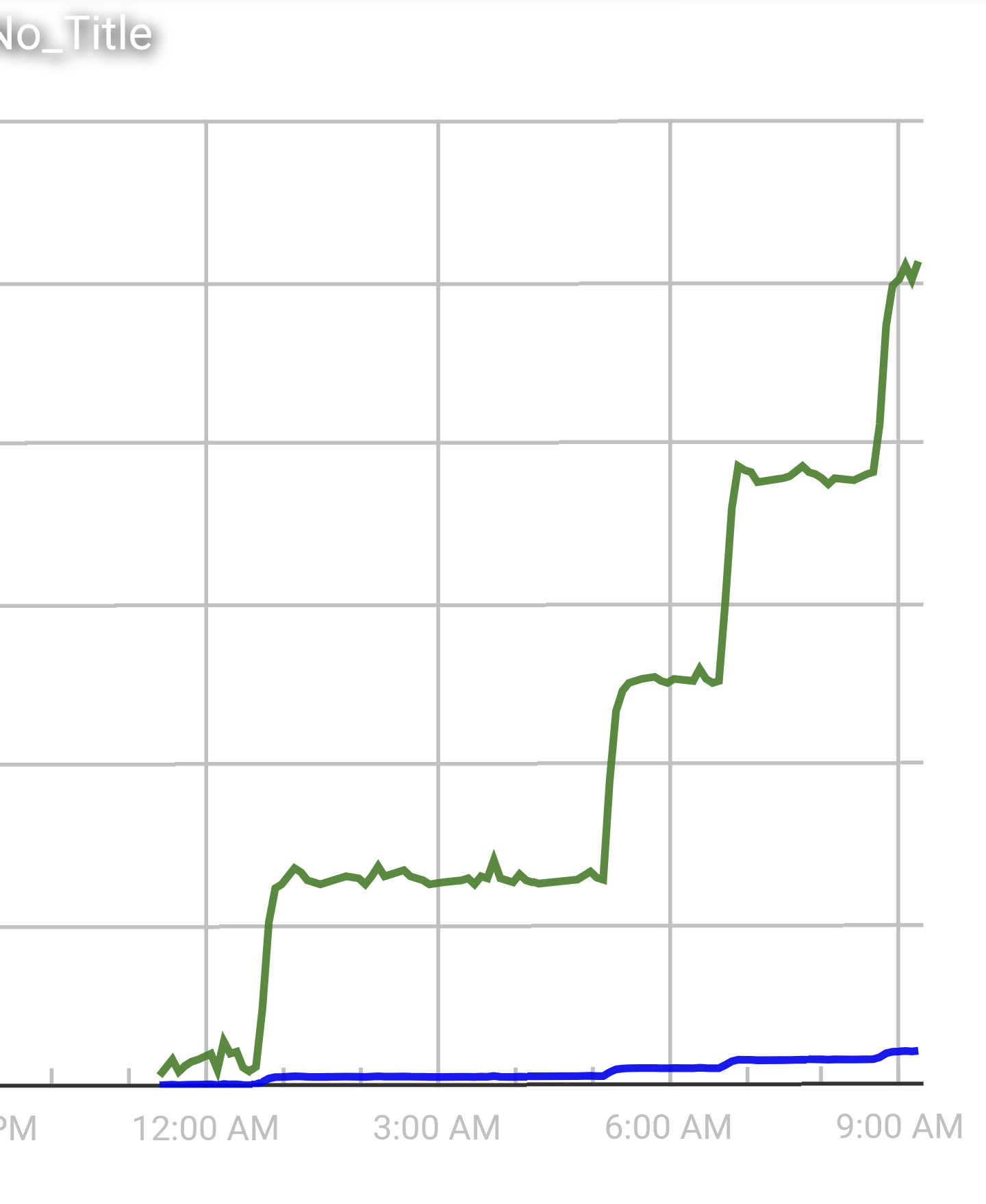

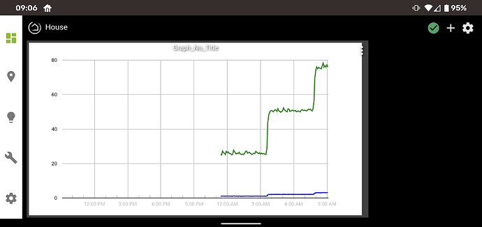

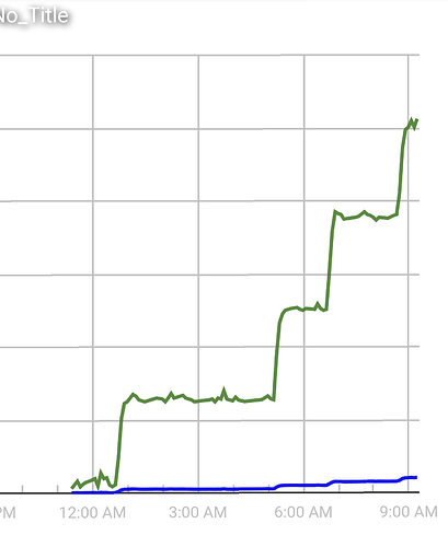

I did get Hub Info setup with Hubigraphs last night and woke to the CPU load alert this morning. Based on the graph, it almost looks like a process is getting stuck. Green is CPU and blue is 5minCPU.
Just for reference with my Ecobee suite install I still have the polling at default and I use 3 sensors. Though it is a bit of a hog it isn't doing anything like causing the cpu to spike like that. To me this looks like it may be a race condition occurring. Considering that Ecobee can function completely without Hubitat have you tried uninstalling it to see if this still occurs.
I would also suggest you take a look at the runtime stats to see what are the big contenders for these events. Now that you have these graphs to it might be nice to try to zero in on the time intervals where this occurs. If the time the event occurs is predictable maybe clear the stats right before you expect the event to occur and then watch the stats for what appears to be the big hitter.
It would be interesting to compare day over day to see if the pattern matches. looks like around a 3.5 hour gap between the spikes.

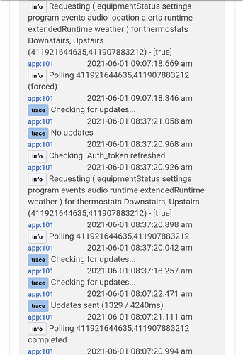

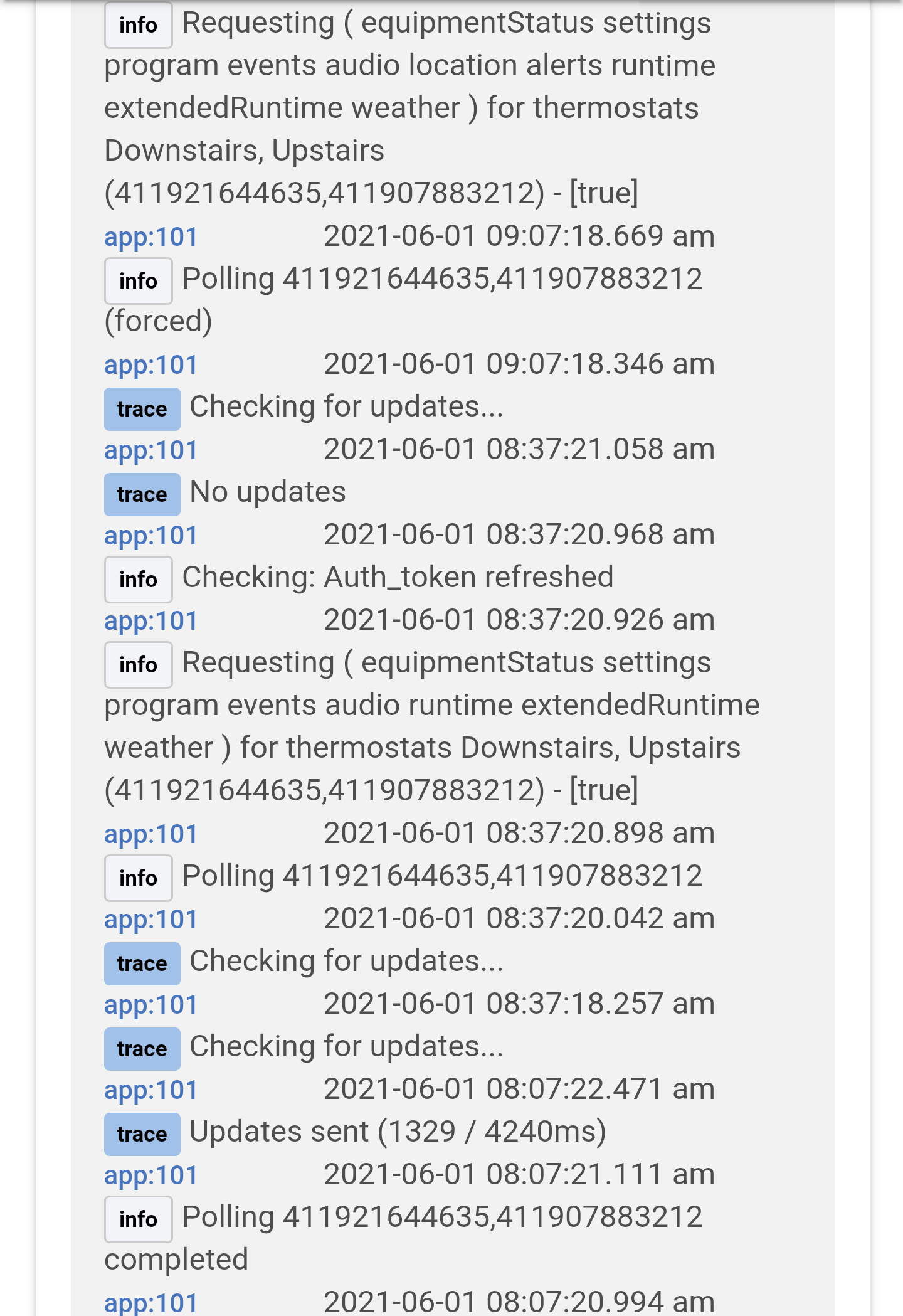

So much for that. Didn't even make it 24 hours. I re-added ESM, changed the polling to 30 min, only added the two thermostats, and setup two mode change helpers that watch some virtual switches. The spikes correlate to polling events.
