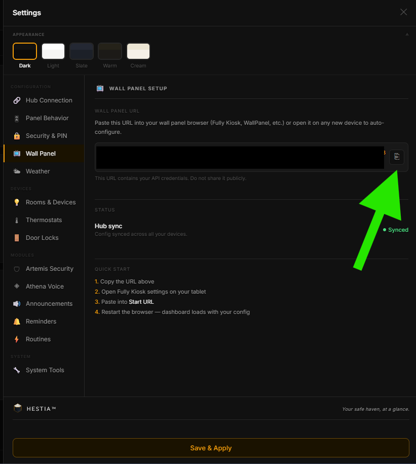

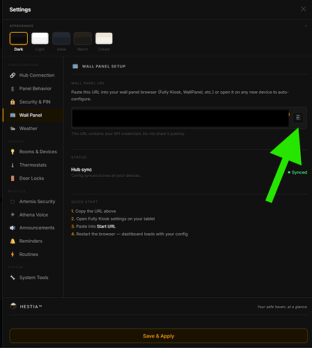

Can you please go to Hestari.com > Dashboard > Settings > Wall Panel
Copy the Wall Panel link and paste it over to Fully Kiosk and try now?

Thanks again for looking into this, on my fire tablet 7 the only way I can get it to work is if I paste http:///local/hestia-token.json into start in Fully Kiosk when I copied the url from the wall panel in the app it comes up with the start screen to fill in the information from maker api and then when tested won’t let it connect. for my fire HD 8 it will only load a partial top portion of the app screen no matter what I paste in the start url no start screen to input information and the buttons that do show don’t function. again I did get it working fine on my samsung tablet and my pc all devices are on the same network. I can run other dashboard with the maker api id’s
