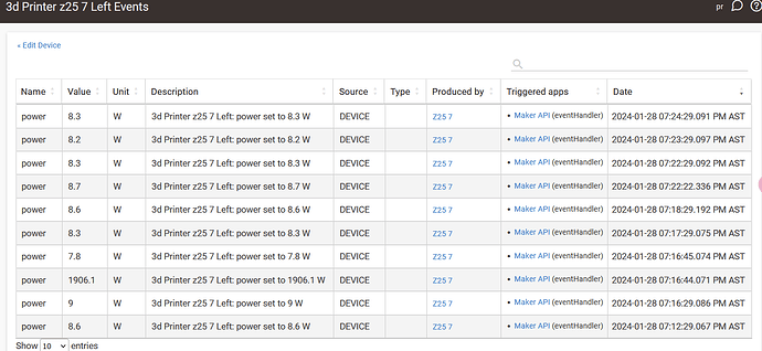

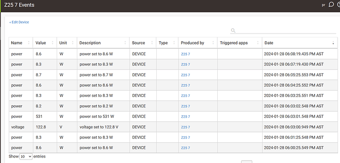

I have a feeling your mesh is being overloaded from all the ZEN25 reporting so a lot of stuff is getting lost. Your Z25.7 device in the details screenshot up above has a lot of route changes which means it is having issues pushing all of its reports back to the hub in a timely fashion.
I don't think that was it: I reflashed the firmware, and it seems to be working just fine now (other than spikes)

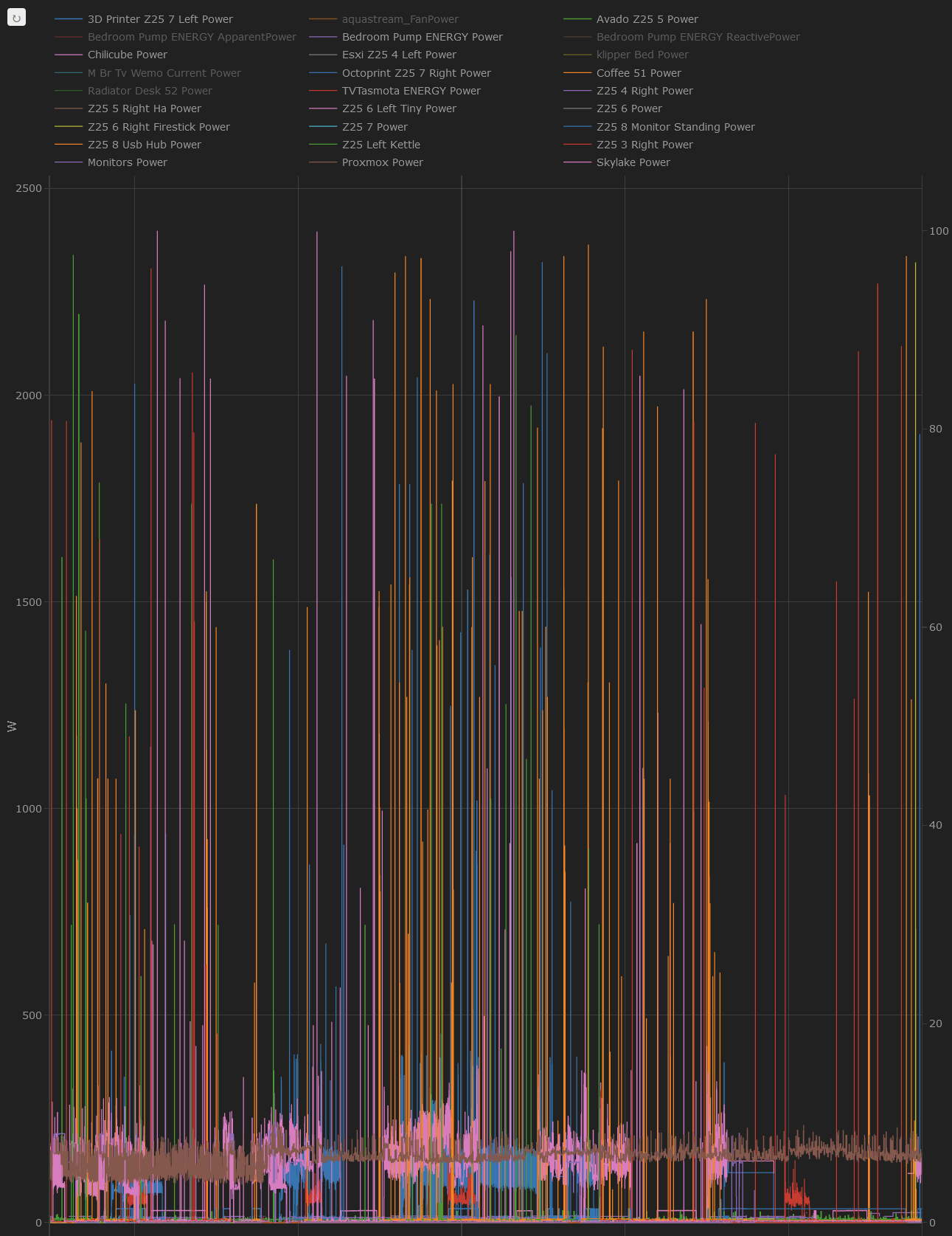

I suspect I notice the spikes more since I forward data over to home assistant:
Would it be useful if you could set a max power per each device and then it would filter out anything higher? Instead of trying to do some sort of a factor.
I set the max to 1000w, and will monitor. Will try and figure out if its reporting other spikes that are less than 1000w. I think I've only got one machine that could actually pull 1000w anyways.

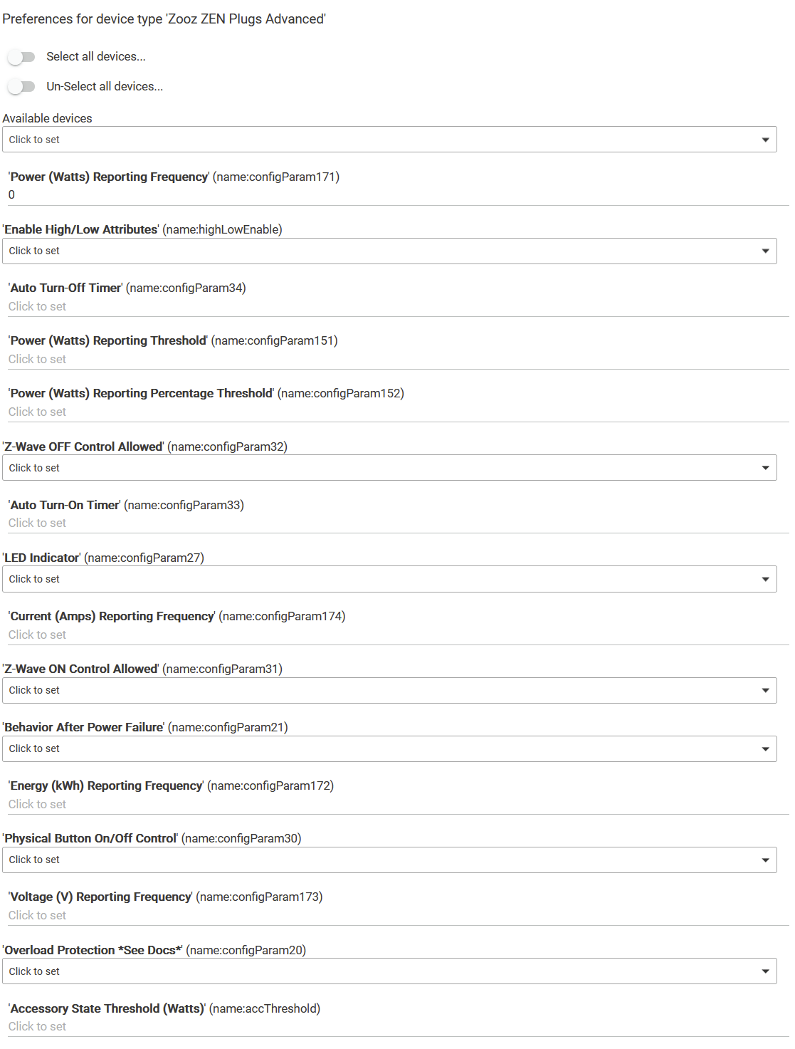

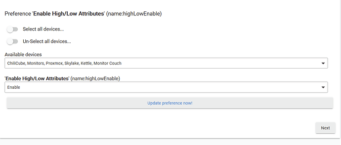

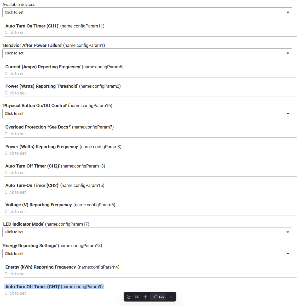

Mostly was trying to use the Preference Manager to bulk set the settings, the Z15 devices showed up with the HighLow option, not the Z25's -
The MCP Advanced driver screen
the Zen Plugs Advanced Driver options:
Ut's muissing
Due to my drivers having dynamic parameters it messes with the way the Preference Manager app works, it is not designed to handle dynamic settings. In order to fix you would have to install the driver a separate time for each type of device you wanted to use it for (and change the title of it), switch the devices to those separated drivers, then re-scan with the prefs manager.

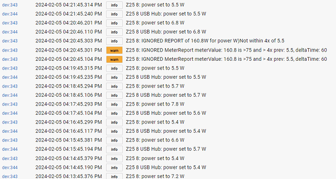

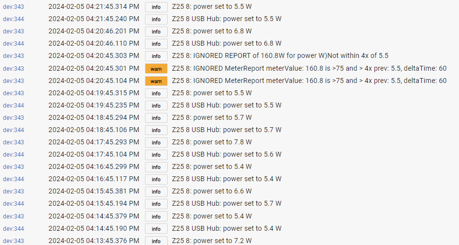

Where is scaledPreviousMeterValue updated?
	switch (meter?.name) {
		case "power":
				// New check for val over 75 and within 400% of the previous value
			if (val > 75){
				if (cmd.scaledPreviousMeterValue != null && (val >= safeToDec(cmd.scaledPreviousMeterValue * 4))) {
					logWarn "IGNORED MeterReport meterValue: ${cmd.scaledMeterValue} is  >75  and > 4x prev: ${cmd.scaledPreviousMeterValue}, deltaTime: ${cmd.deltaTime}"
					sendEventLog(name:"warnings", value:(device.currentValue("warnings")?:0)+1, isStateChange:true, desc:"IGNORED REPORT of ${val}${meter.unit} for ${meter.name} " + "${meter.unit})" + "Not within 4x of ${cmd.scaledPreviousMeterValue}", ep)
					return
			break
		default:
			break
I added this function, which mostly works, except it also triggers when the scaledPreviousMeterValue itself was invalid.
But otherwise works great, like when a Z25 somehow thinks a usb hub draws 160w
Not sure what you mean? It is value in the cmd object that gets parsed by the hub and passed to the zwave functions. I would need to see what function you are adding that code block to.
