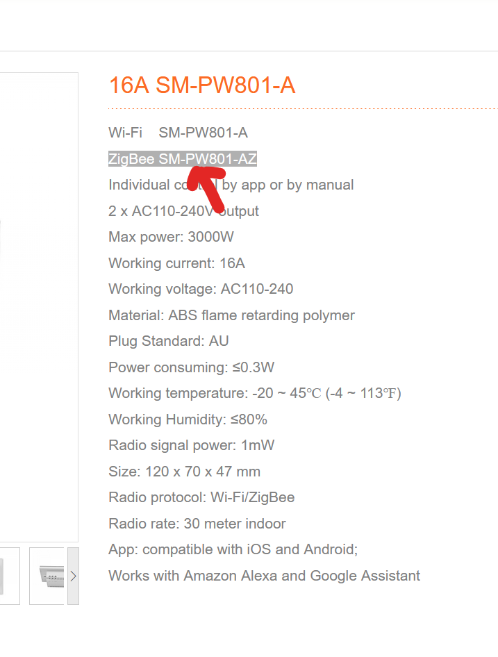

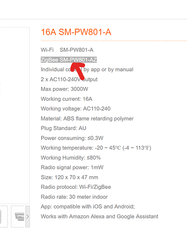

Are you in AU/NZ? Is this the device?
If it is, I'm not seeing any indication of it supporting either zigbee 3.0 or ZHA 1.2 - a prerequisite for working with Hubitat.
there is a zigbee version
Where does it say that it supports either zigbee 3.0 or ZHA 1.2?
There are lots of zigbee devices that support neither zigbee 3.0 nor ZHA 1.2. For example, all the zigbee devices made by Control4 or even Iris V1 outlets for that matter.
Well it does show different models for wifi and zigbee, though yes it's not specifying 3.0 or 1.2 (which whenever I see that it's just 1.2)
