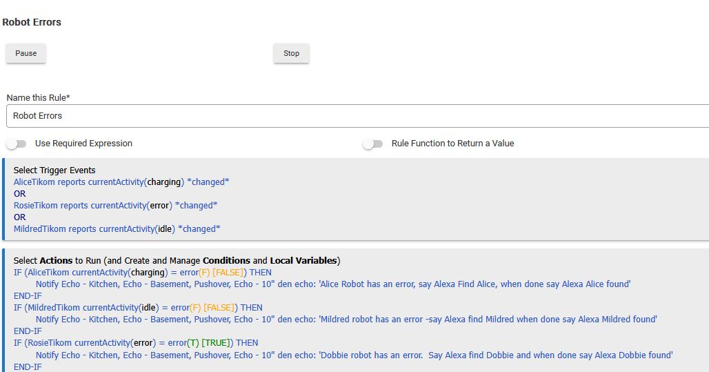

I'm trying to notify myself when a robot vacuum gets an error. The thing i am checking is a custom attribute called currentActivity (which is a String) and I want it to send a notification when it changes to the value error
I have the trigger set to Changed and then do the check... in the screen it shows that it matches error BUT I never get the log.

I think your actions need an ā€œelseā€ in between each if statement?
My uneducated guess is that this is going to be some sort of syntax or typo issue. Is ā€˜error’ something that’s selectable or could you try ā€˜contains’ rather than = if it’s a string.
thanks you both for your input...my concern with else if is that if two are in error it would only deal with the first one, right....
as is, isn't it 3 separate checks?

regarding the "contains" , the 3rd one detects that =error is TRUE so it seems that the check matches?

Your actions don't have any logging, only what appears to be a notification or possibly TTS device. Does that device work if you send the "deviceNotification" command on its device detail page -- to test?
Also, you probably want these as three separate rules, unless you don't mind multiple notifications for the same device (all devices are going to be checked for a value of "error" any time the value for any device changes -- even if that device changing to "error" wasn't what triggered the rule, and even if you already got a notification for that device, for example). If you only care about notifications, a trigger on "error" instead of "*changed*" and no IF THENs necessary in your actions would be a very simple rule -- or set of rules, one for each device -- to write that sounds like a closer match for what you actually want.

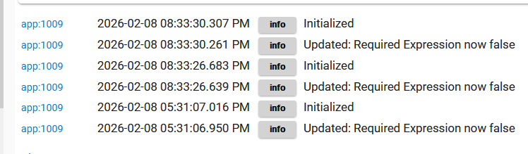

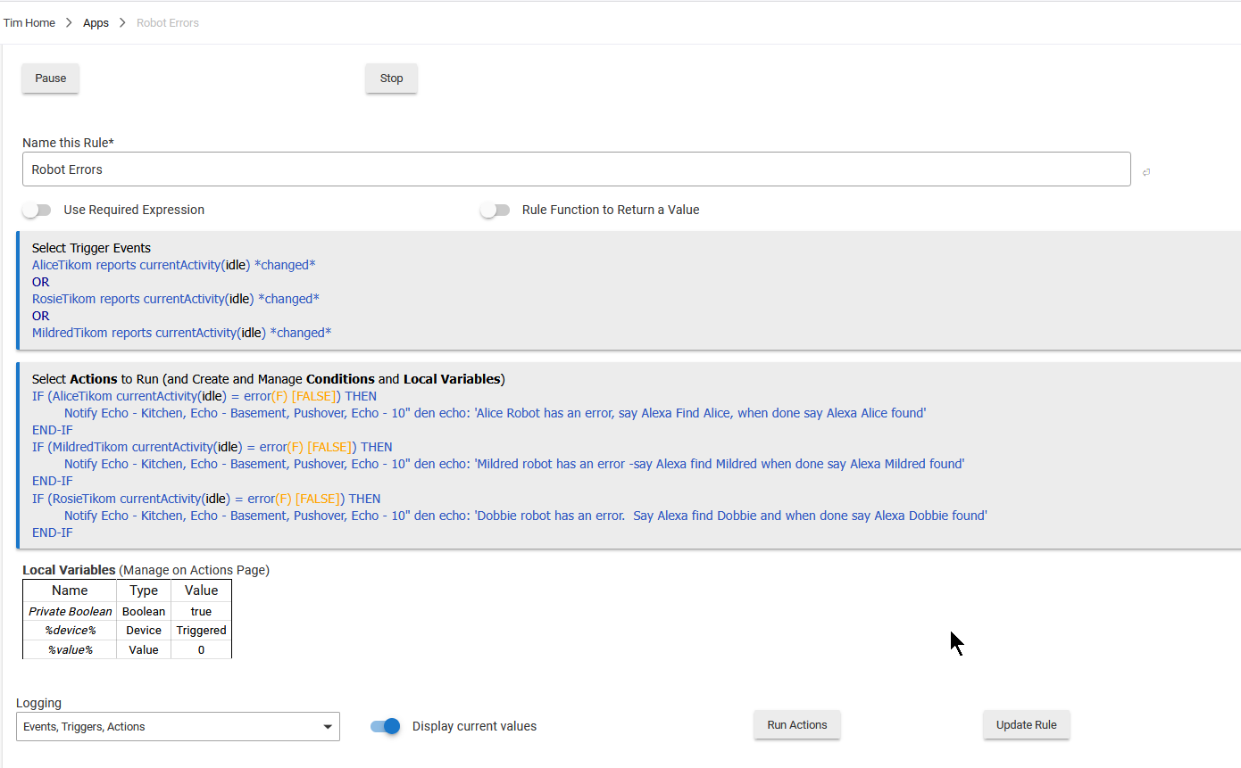

so i disabled the separate ones and reenabled the orig one and did the update rule and save and I did see inits in the log but when I did the set attribute to error from device it STILL did not work. This seems like a bug in rules machine...
What do the log entries for the rule say now?

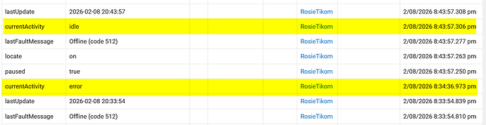

even though it was idle (below this), i then flipped to error (lower yellow) and back to idle (top yellow)
Is this the exact same rule as above? You don't have a required expression there, but the logs say you do -- and also why it isn't triggering.
I saw that.... at one point I DID have a required expression but I removed it a while ago as you can see... maybe THATS the bug.... also the simpler ones I create ( 1 per, i never introduced required expressions) and they worked
BTW....nice catch!
