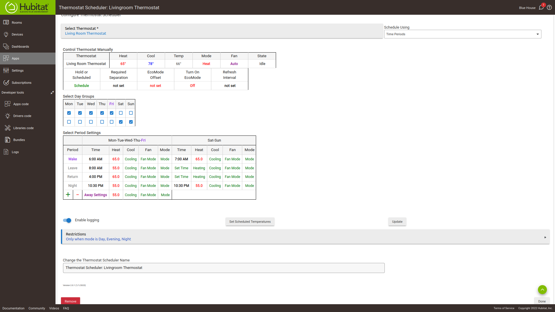

Thermostat scheduler for one on the thermostats: (This is the most simplistic schedule I have)

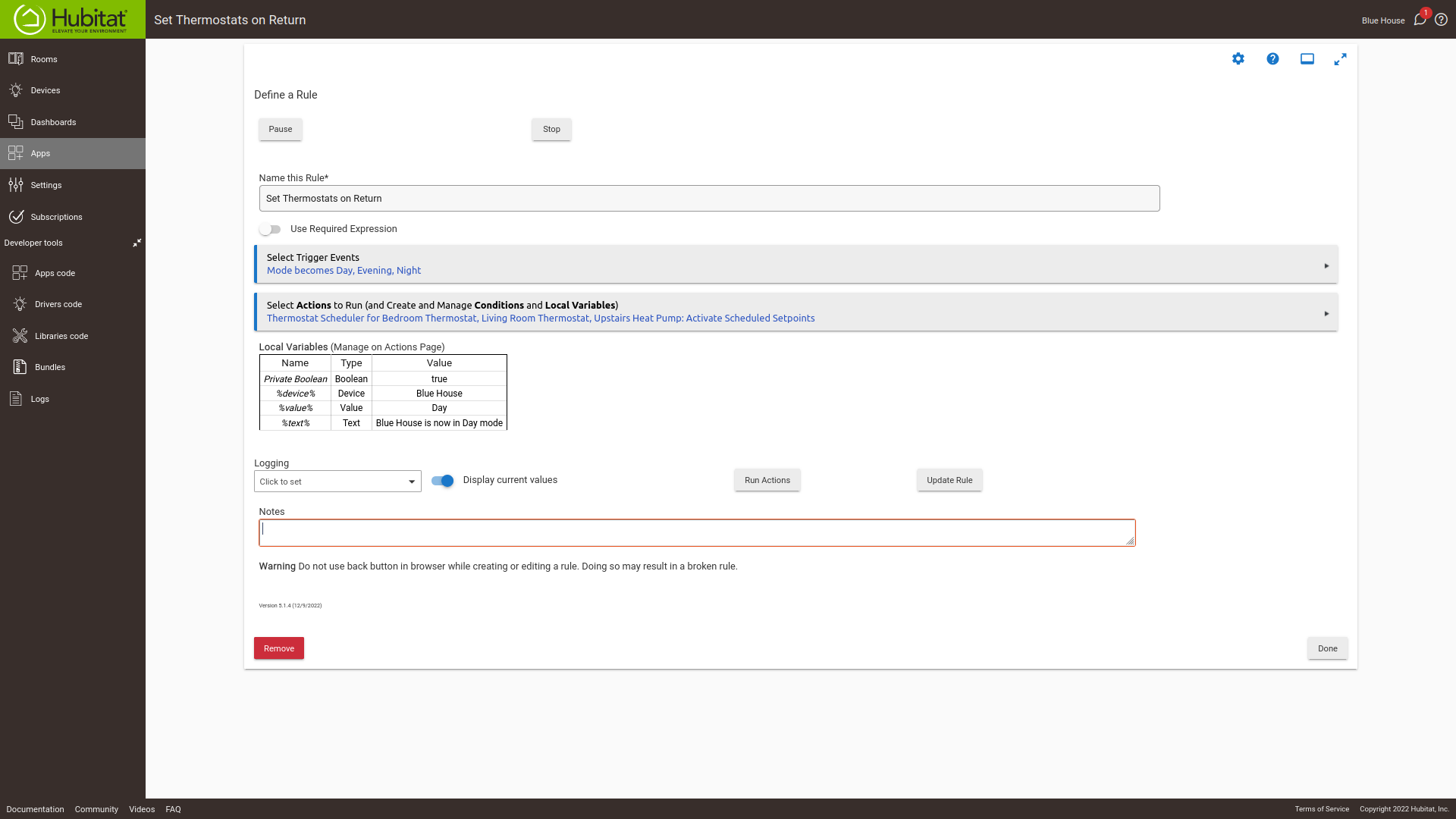

RH to set setpoints on return:
Hrm interesting way of looking at things I did not investigate control with modes. Currently the only difficulty that I see is that I would end up with bunch of extra modes that only TS cares about. As I control different zones/thermostats throughout my house with schedules. I am sure there is some overlap so maybe I can optimize. Absolutely worth investigating though.
Implemented. We will see how this works over the few weeks and I will update with my experiences.
So far my drawbacks are:
  1. Lots of modes.
  2. Loss of time information in the TS making it a little more confusing for other family members to adjust heating schedules.
  3. Modes in TS are alpha sorted instead of time sorted.
I will mark this as solved.
