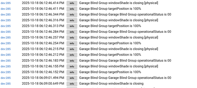

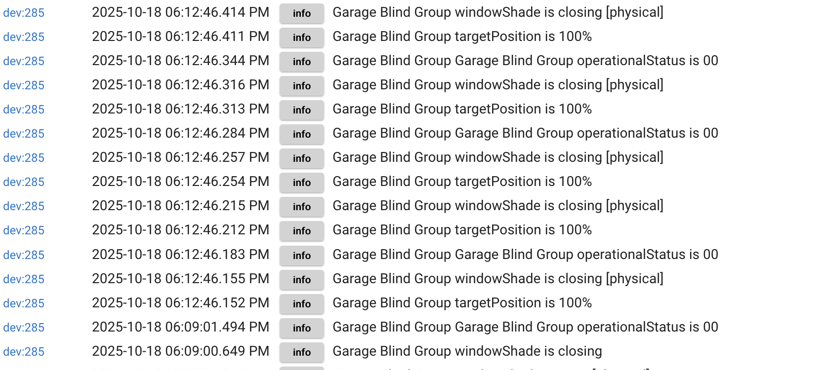

Well here we go again. Today at Sunset the Garage Blind Group and the Office Blind did not close as expected. I have some logs to inspect.
After some inspecting of the logs I am still confused. When they opened this morning there are 3 entries. Office blind opening-Office Bling windowShade is opening and Office Blind windowshade is open (digital).
At Sunset when they were supposed to close I get 2 entries Office Blind windowShade is opening and Office Blind operational status is 00. I closed them with the Switchbot app at 6:12pm Sunset was at 6:09pm. The rest of the blinds closed as expected.
What I can gather from this is that Office Blind operational status is 00 means that there was a problem with communication to the blind therefore it did not close.
What bugs me is that some of the blinds closed and some didn't. But I don't know what to do about it. They worked all week without a hitch. Any Suggestions?
The 'operationalStatus' is reported from the device via the Matter Bridge, and code 00 means 'unknown'. The possible values are 00-'unknown', 01-'open', 02-'closed', 03-'opening', 04-'closing', 05-'partially open'. I don't know in which cases the bridge will report 'unknown'...
