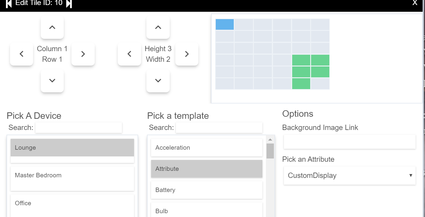

Thank being said, I'm having trouble setting up the app. I thought I had it installed correctly, however when I go to add a tile to a dashboard I cannot find an attribute named "Custom Tile..." (as I've seen in other posts).
Can someone see where I'm messing up?
BTW I don't recall the order in which I copied the two apps into the Hub (SuperTile and SuperTile Display). Could the order be significant?
John
The SuperTile device, needs the "Tenplate = Attribute" in the "Pick a template" list.
Then select the drop down to be "CustomDisplay"
Whatever you have in there though, has to change and be updated in some way before it will display on the tile.
PS. I doubt very much you are going against Andy's(@Cobra) wishes :wink:
Thanks :slight_smile: That was one of the few permutations I didn't try. Funny.....now that you showed me the solution it seem very obvious

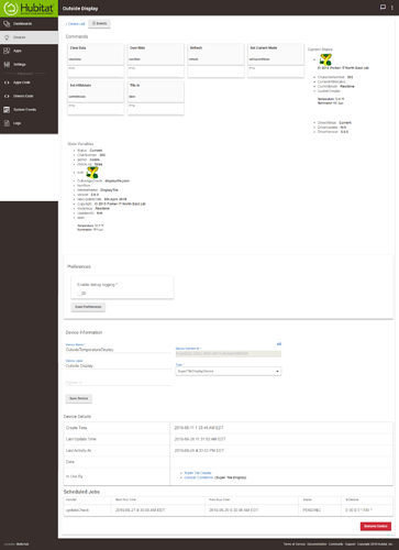

In the screen shot below, the SuperTile "tile" displays the device name almost off the bottom of the tile.
Is this something I did wrong or is it so all the configurable lines can fit on the tile?
John
Hi @JohnRob,
A little difficult to say. Can you add a screenshot of the device states, of the SuperTile device you've used? Is the name of the tile just "Outside Didplay" or is there more there?

The requested screenshot is below but I think you've answered my question....it is not normal.

Hi John,
Sorry. I meant a screenshot of the Outside Display virtual device. You should see the data in that device which will be displayed on the tile, on the dash.
Cheers
Roy
Could be I don't understand the installation sequence. I don't have a Hubitat "Virtual" device I have a device of type "SuperTileDisplayDevice".

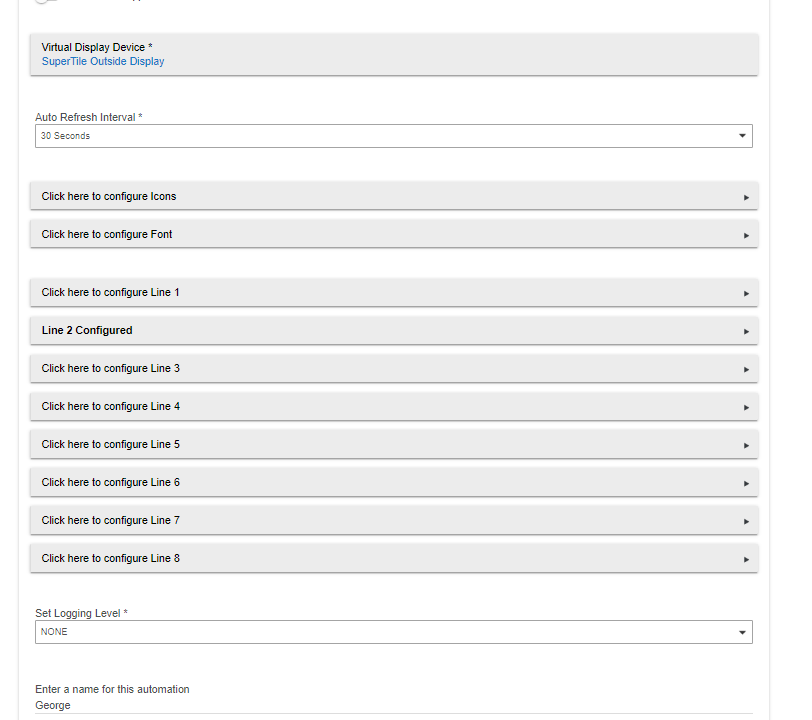

My only question is shown in the yellow oval.
John
Sorry the third is what I was after. Itlooks like you havent configured Line 1?
I would start at Line 1, then Line 2. Then see how it looks?
Is there anything in the rest of the lines?
