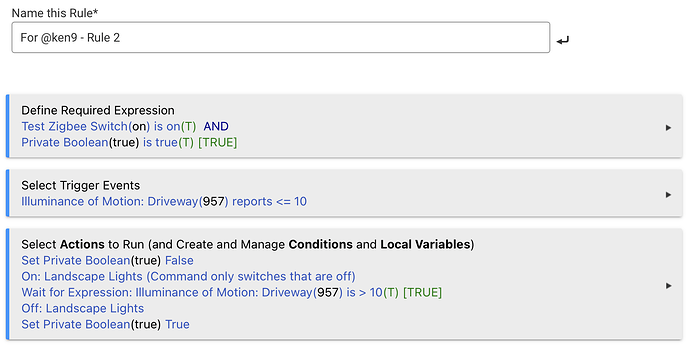

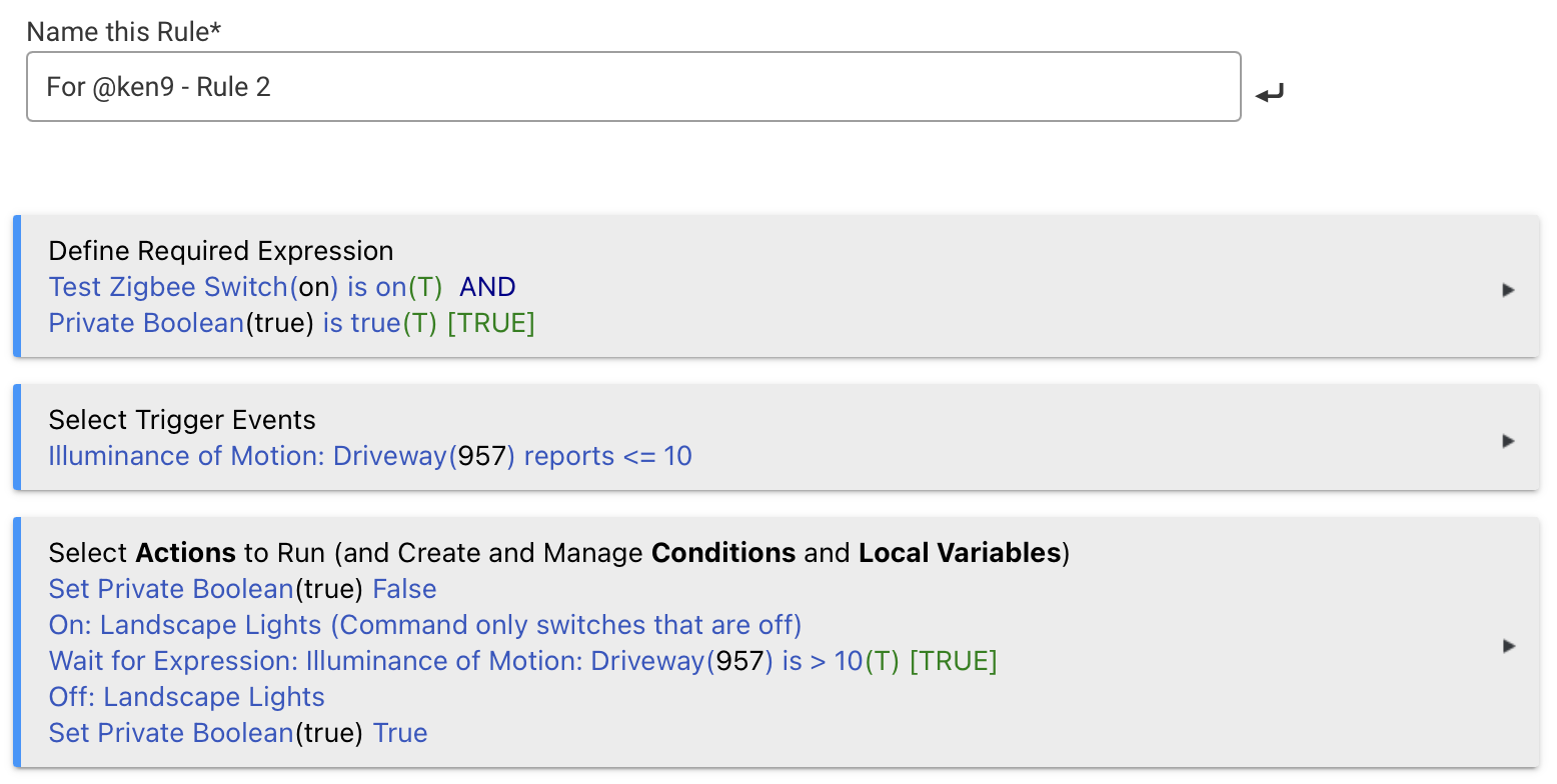

Rule 2: Controls the lighting
This rule is restricted to run only when the pump is running. It turns on the lights if the lux is below a certain value and turns off the lights if the lux exceeds that value.

In this case (referencing screenshots above), there's no IF statement involved, so no need for END-IF.
But in cases where an IF stmt is involved, it's good technique (and often essential) to close every IF statement with a corresponding END-IF.
You can get a way with not doing it if just one IF statement is used in the rule, but just doing every time ensure you're always covered.
As @hydro311 indicated, my rules have no IF statement. So there's no ENDIF needed. Would you like me to give you the rules as TXT files that you can import into Rule Machine?

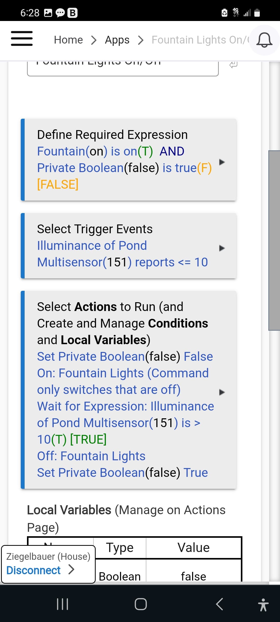

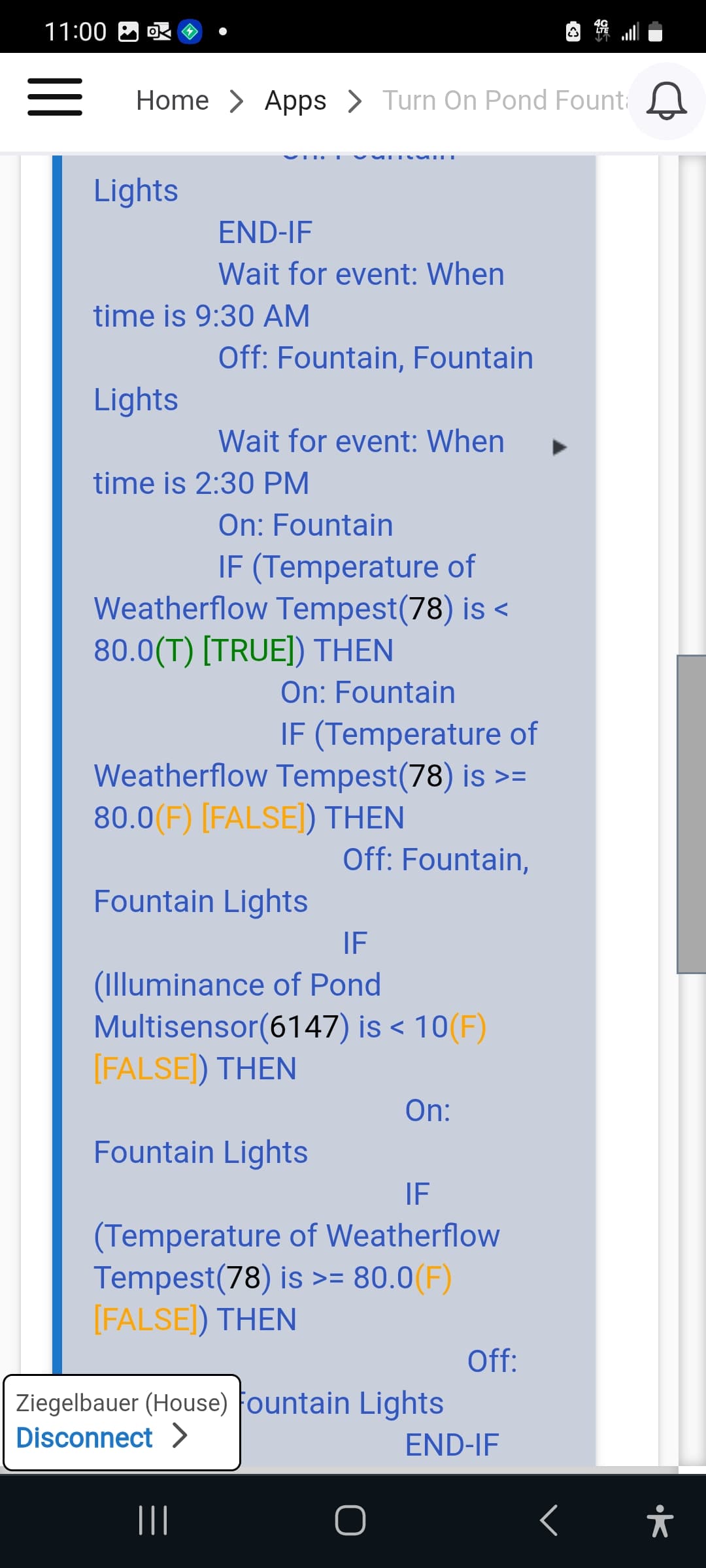

Tried to upload your rule and it won't load. It says wrong format. I copied your examples exactly and thought everything was working. Got up at 2:30 am and fountain and lights were still on. I turned off the fountain and the lights stayed on. This morning it did not turn on automatically at 5:00 am. When I clicked on run actions within the rule it did start up then. Not sure if it matters but it is a Zooz Zen14 that I am using for the lights and fountain?

In your Fountain Lights rule, Private Boolean is (false) making the Required Expression [FALSE], so the rule will not be Triggered. However after you have manually run the actions once, it sets Private Boolean to [TRUE] and the rule should run the next time.
Note: Private Boolean is used to keep the rule from triggering during the "Wait" period of the "Actions" phase of the Rule. The first action sets Private Boolean to (false) so the Rule won't be triggered while it waits for the Expression Illuminance of Pond Multisensor to become [TRUE].
In your second rule, I'm pretty sure you want the first action to be PB set to False (not true).
