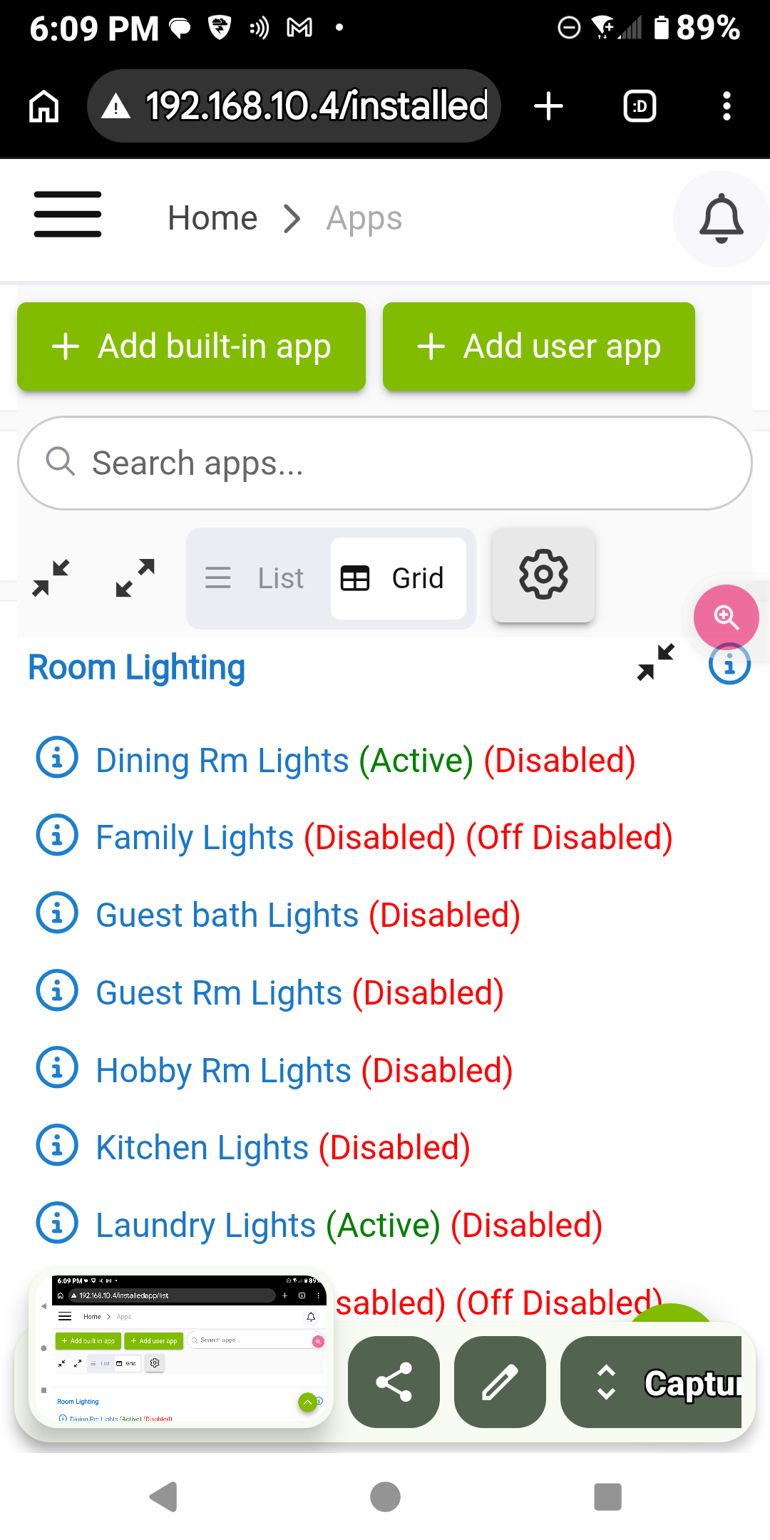

Hey Simon. I tried the app room lighting as you suggested. I was very hopefully it would work. Why does it do this?
Now they work whenever it wants and that is not when the motion sensor activates, but since it is acting up, I reactivated my button rules so I can at least use the buttons to control them
