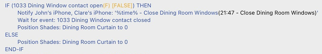

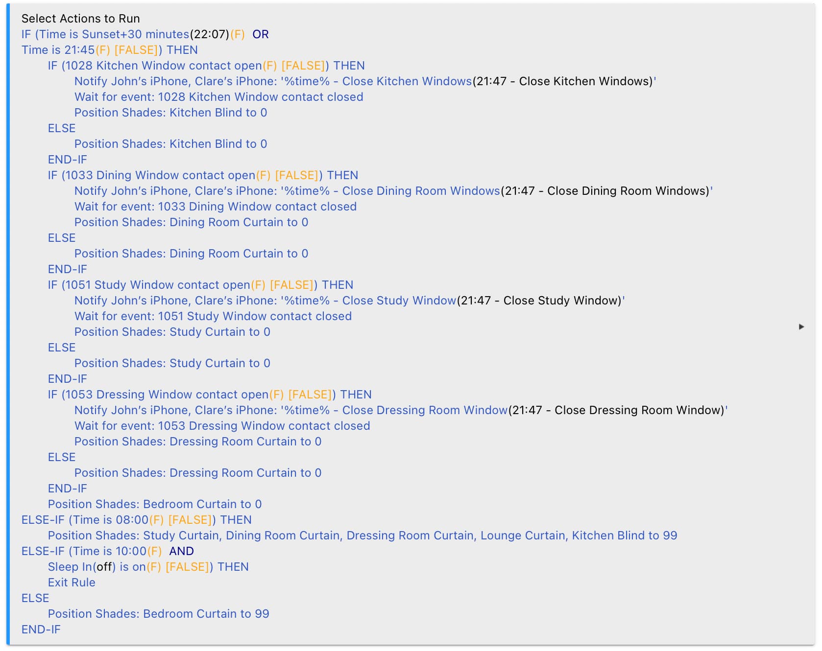

It looks like I've made a mess of this rule. I assumed (wrongly) that a 'wait for event' in one IF/THEN statement in the rule, would not stop the rest of the rule from running, just the remaining elements before the corresponding END IF. Unfortunately everything stops at the first open window. My rule is below. Is there a better way of doing this? I want the curtains to close at a given time but if the corresponding window is open I want it to notify me and wait until the window is closed. However I don't want to hold up the actions at the other windows. I also don't want 1 rule per window.
I suppose I could make it carry out the actions for every curtain where it's window is closed first, before rerunning again for open windows:
If Window 1 closed, close curtain 1
End If
If Window 2 closed, close curtain 2
End If
If Window 1 open, wait until window 1 closed, close curtain 1
End If
etc, etc. It seems a bit pants though

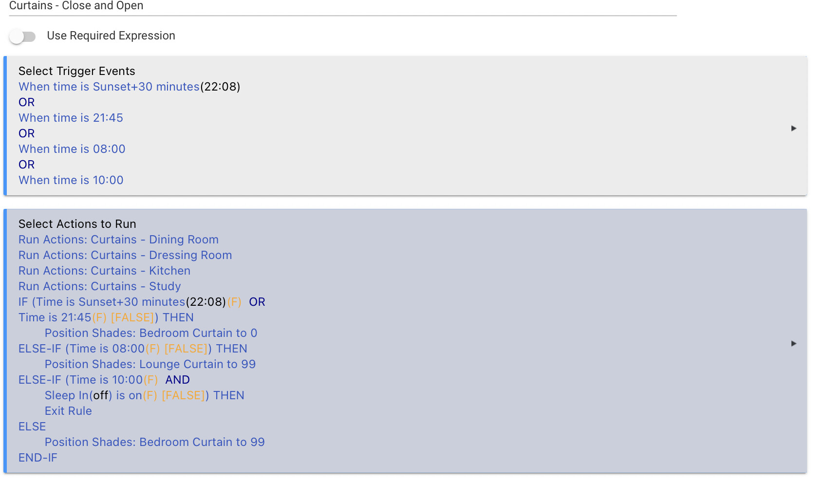

So I've implemented the method that @Sebastien suggested - a main rule running the actions of sub rules. Also in the main rule are actions for:
  • windows where there is a curtain to be closed but the window has no contact to monitor
  • an open command for the lounge curtain which is closed independently

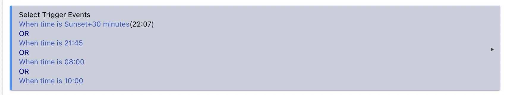

The main rule:

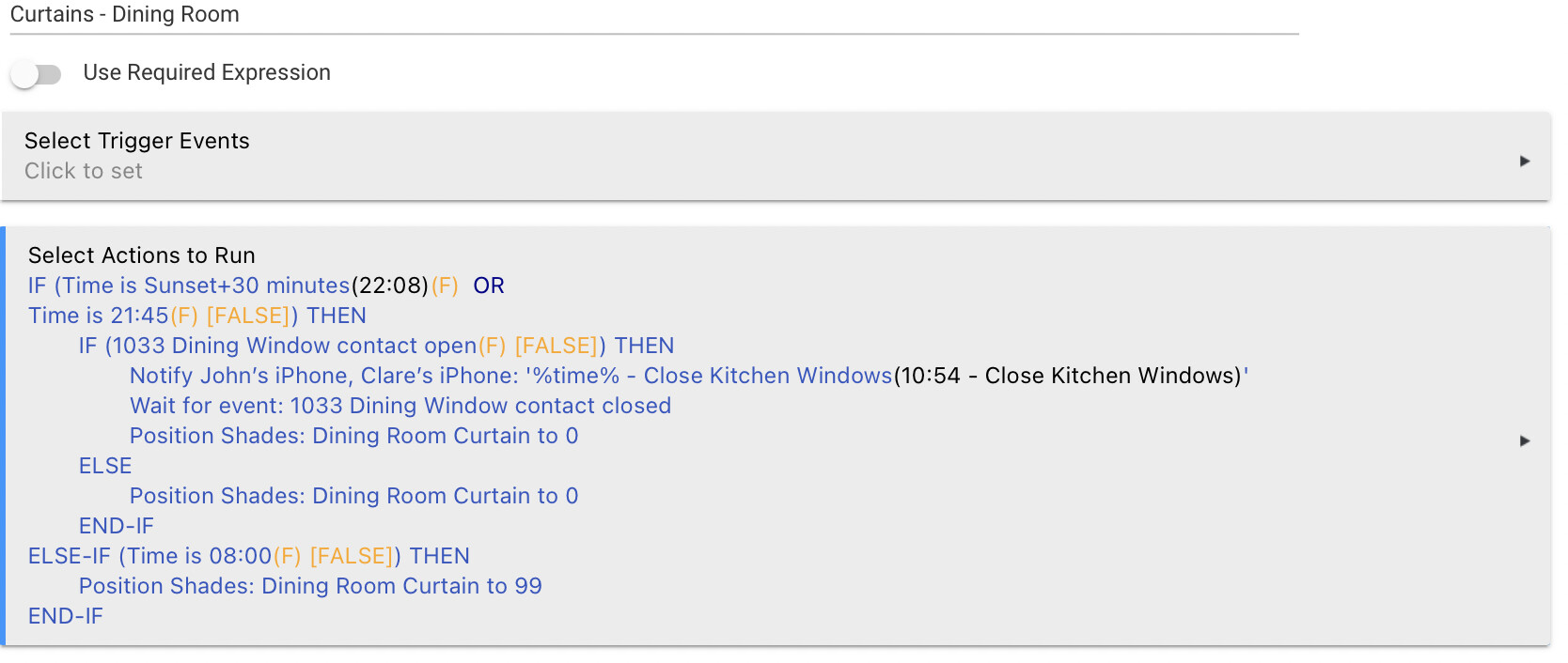

One of the sub rules:
I've also installed the Device Status Announcer suggested by Sebastien in another thread and set it to run 5 minutes before the above main rule.
Thanks for everyones suggestions, they're very much appreciated.
