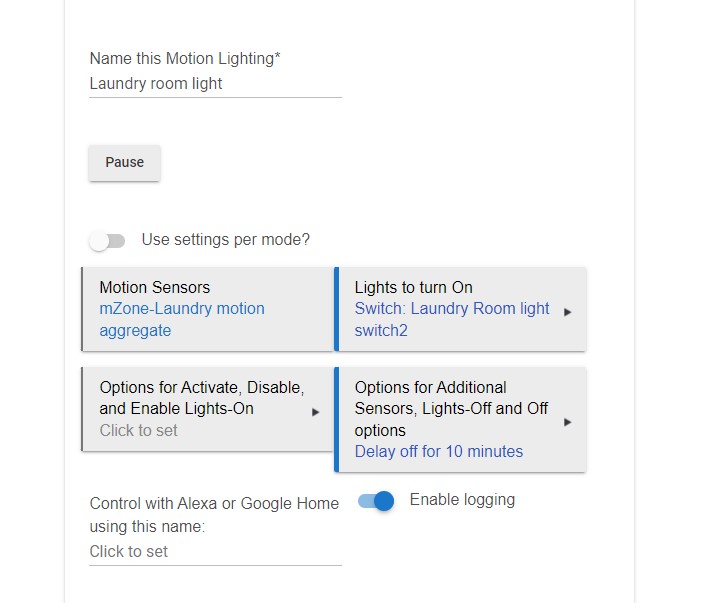

Yes, there are various ways to accomplish this. Rather than check multiple times for inactivity you could use Motion Lighting and increase the delay time. I had an issue in my Laundry room where my wife would complain about the lights going off while she was in there. I just increased the delay to 10 minutes and this solved it. If there is any motion detected within the 10 minutes it resets the trigger.....

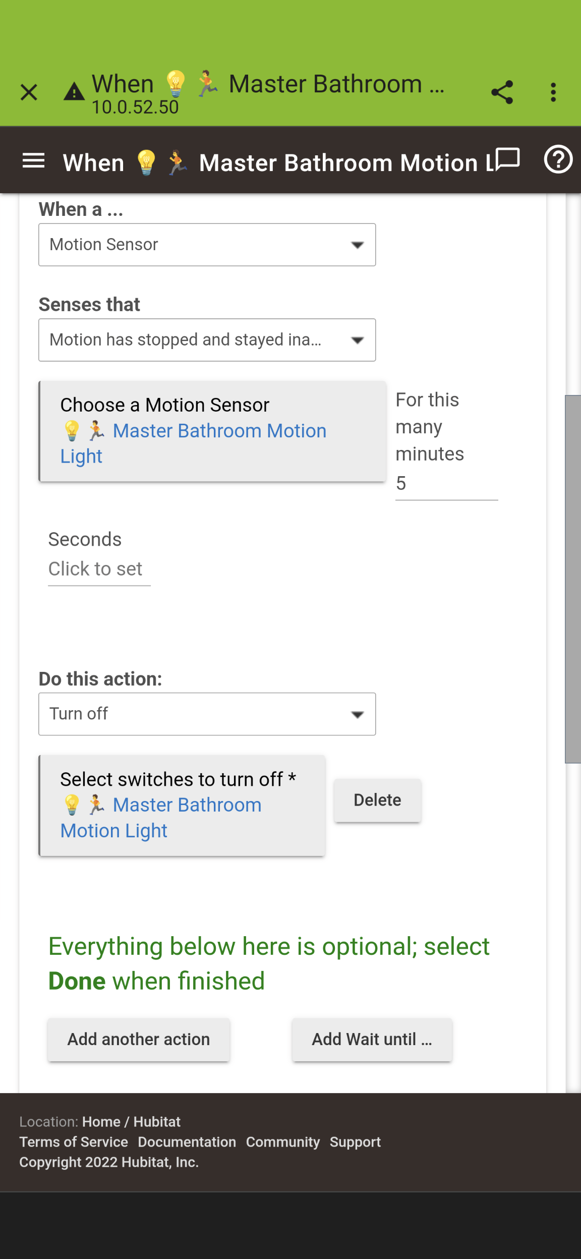

This has so far done what I was looking for. I was pretty much in the same boat. Fiance forgets to turn off lights so I was using the motion sensor to turn them off but the event enunciation was to quick if we happen to be inside and stand still for a few seconds.
It sounds like this is what I was trying to do in RM but the motion app seems to have done the same trick.

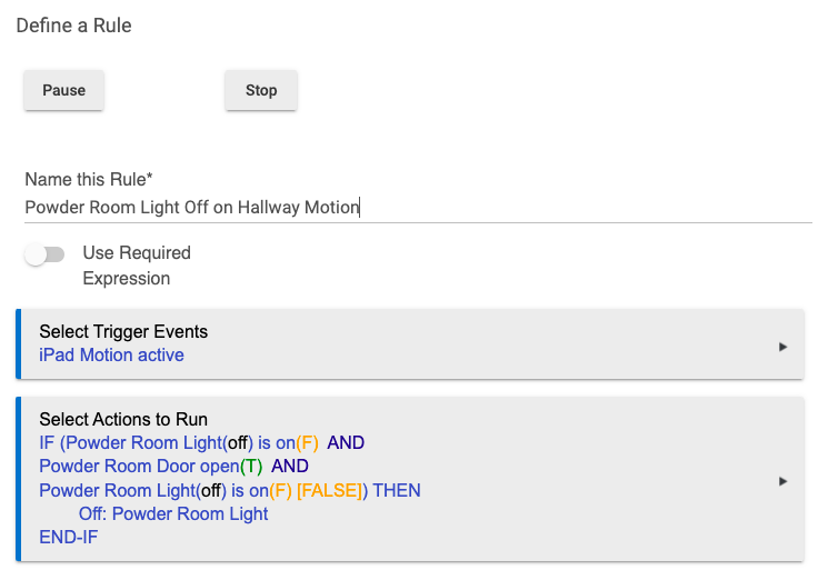

I've taken a different approach to resolve this. I have a motion sensor in the bathroom that turns the light on when motion is detected. I also have a contact sensor on the door in this bathroom that turns the light off when it opens. Doing this it doesn't matter how long a person is in the bathroom the light will stay on until the door opens. To handle the times when someone goes in the bathroom and doesn't close the door I've setup a rule in RM to turn off the light if the motion detector in the hallway leading to the bathroom is triggered and the door is open. This approach has worked flawless for several months.
