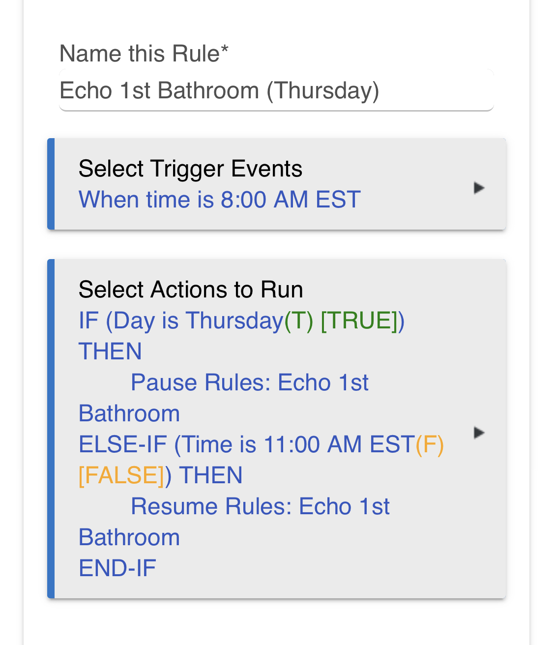

I’ve been trying to get this rule to work with no success, looking for advice. The rule I need would pause another rule from running on Thursdays between 8am and 11am. Below is what I have now.

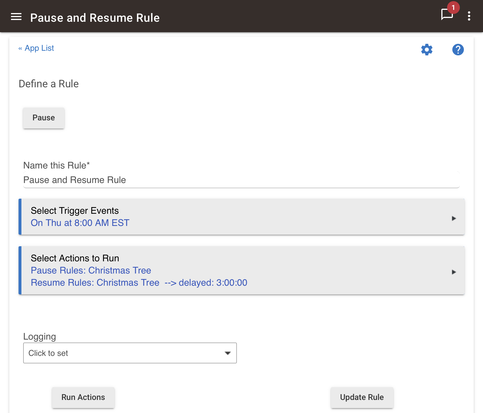

Add another trigger for 11am. As it is written now, it will only run once, at 8am. As written, it will never resume the rule.
Here is how I would write it...
Will I also need to change the actions then? To incorporate the different times? If I just add 11am as a trigger won’t it pause it again at 11?
Good point. See my update to my reply above, showing a much simpler rule with should Pause and Resume your rule.
Thanks, I like your example. Looks much cleaner
