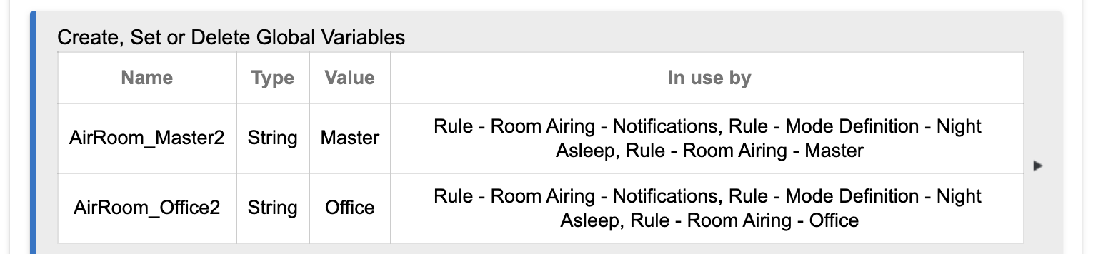

OK, so I finally had some time to progress this a bit. Here is what I've done based on two rooms only:
I haven't tested it yet, but:
  1. Are there any obvious flaws / errors in the above?
  2. What's a better way to put together those hourly notifications? What I currently have will result in a lot of 'na' for those devices that really should be excluded from the notification message itself, but I couldn't figure out a better way to do it...
